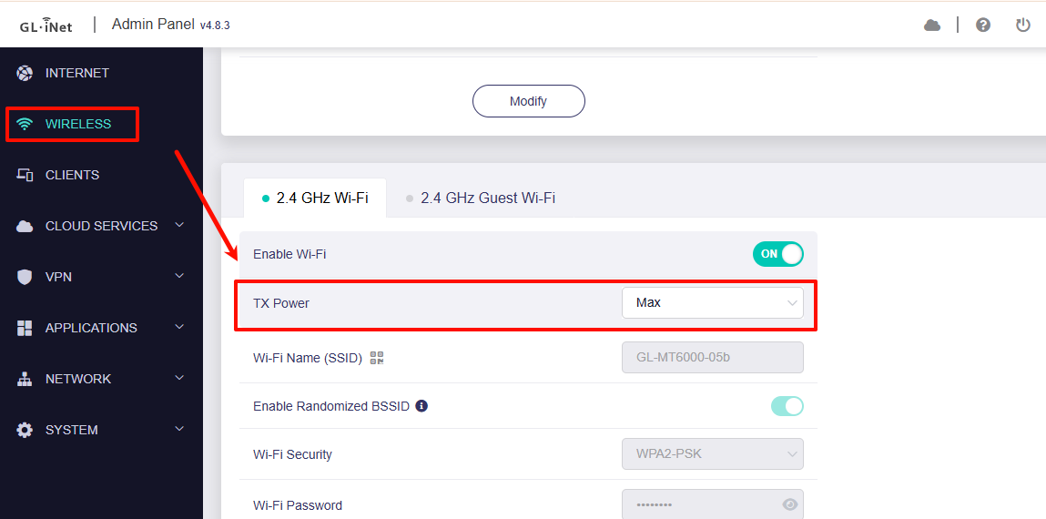

Please refer to this tutorial to configure the country code according to your region:
Cannot Scan Android 5G Hotspot - GL.iNet Router Docs 4
Afterwards, go to GL UI → Admin Panel → Wireless and set the transmit power to maximum.
This ensures the router operates at the highest signal strength permitted by regional regulations and hardware limits.
If the camera still has trouble connecting, try adjusting the antenna orientation or switching to a Wi-Fi band with less interference.
