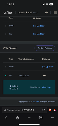

Hi, I've enabled Wireguard on the Flint2, created the Peer for my phone, installed the Wireguard app on my phone, and copied my QR code. But when I try to connect my phone to the router's VPN, I can't browse and I have no internet. Do I need to configure anything else?
Thank you.
Is this normal??

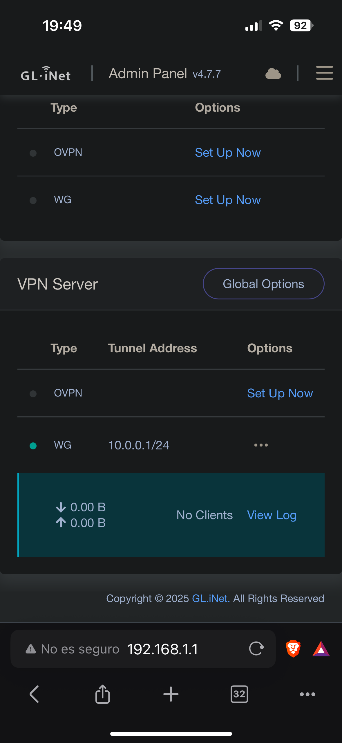

Can you see a connection and traffic passing through on the VPN Dashboard?

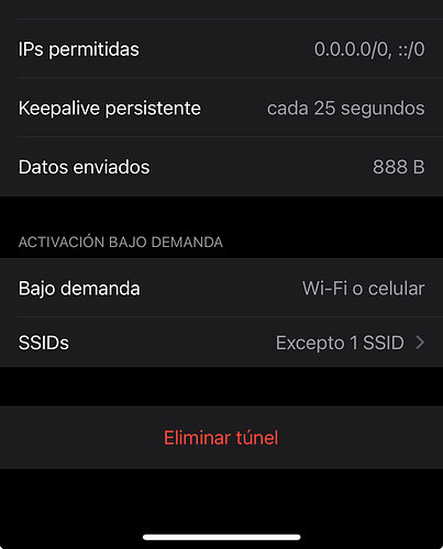

Hi, yes, it's my first flint2, but I have a Xiaomi AX3600 with OpenWRT and WireGuard works fine. On flint2, I only get it to work properly for 2 hours, then I can't reconnect. I see that the phone sends packets but doesn't receive, and on the router, it doesn't receive anything. I have to reset flint2 to factory settings and recreate the VPN. It works again for 2 hours until it fails again. I don't know what to do.

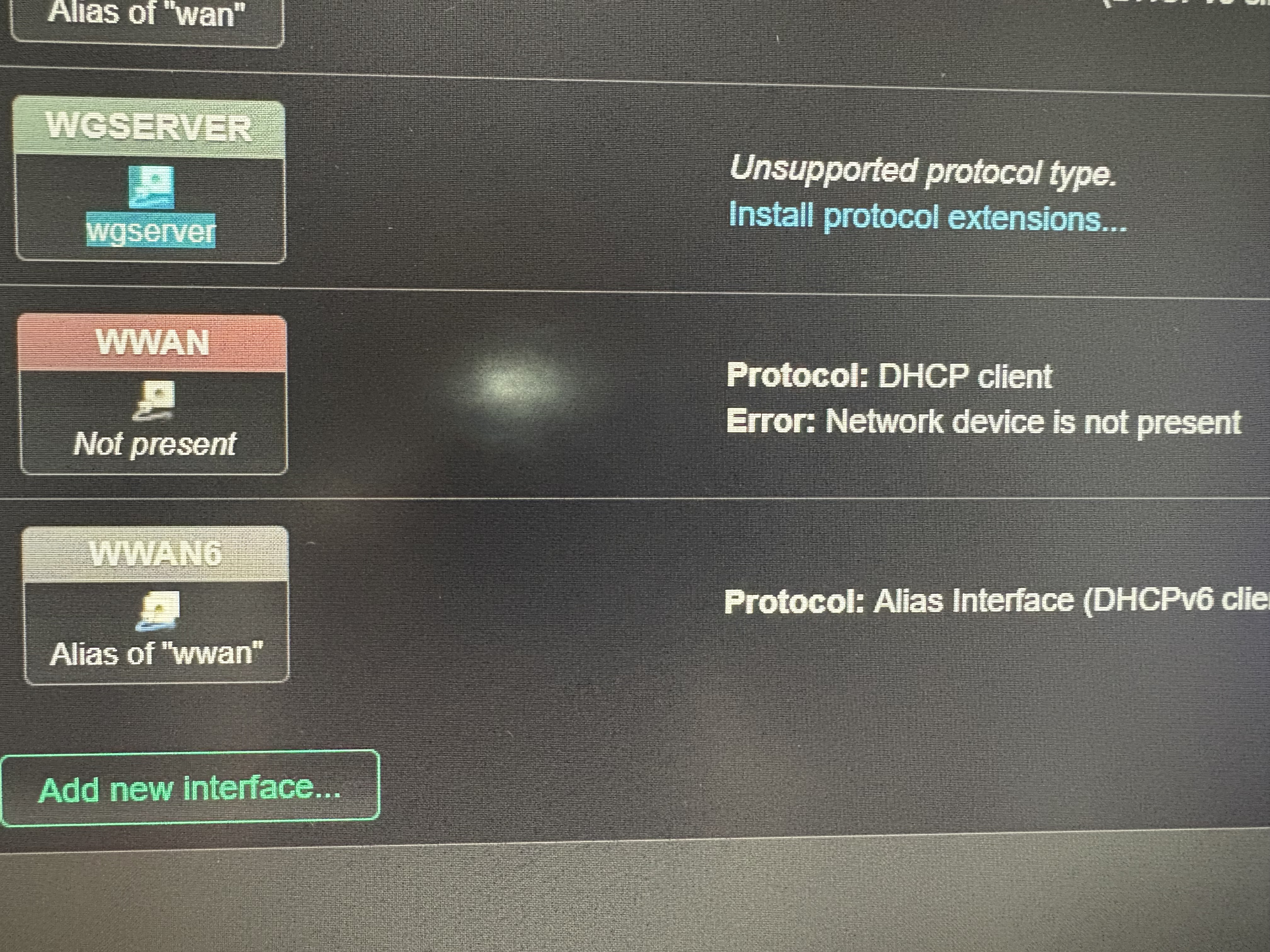

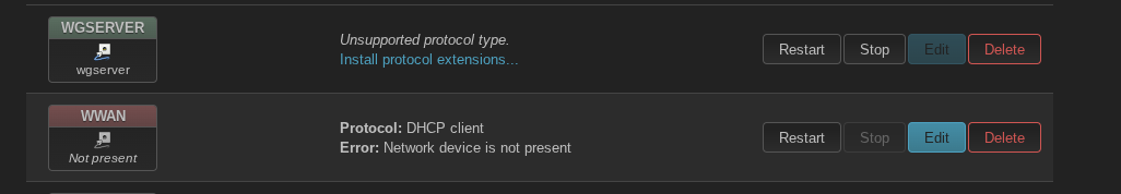

VPN service is based on the GL GUI. Please operate and control it on the GL GUI.
The OVPN/WG interface displays on Luci inaccurate information.

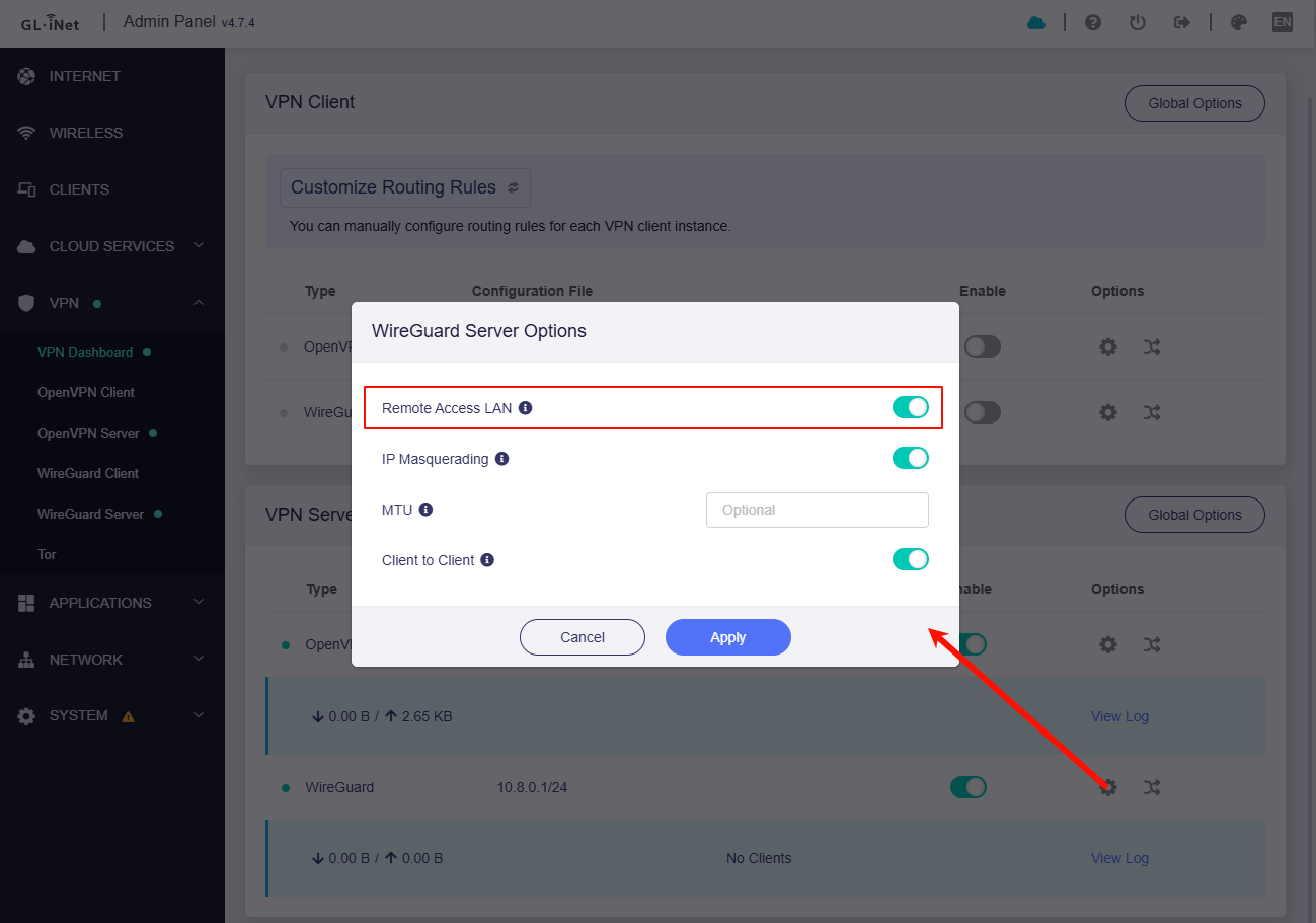

  3. When a issue occurs, is the client's VPN still connected? Please enable Remote Access LAN

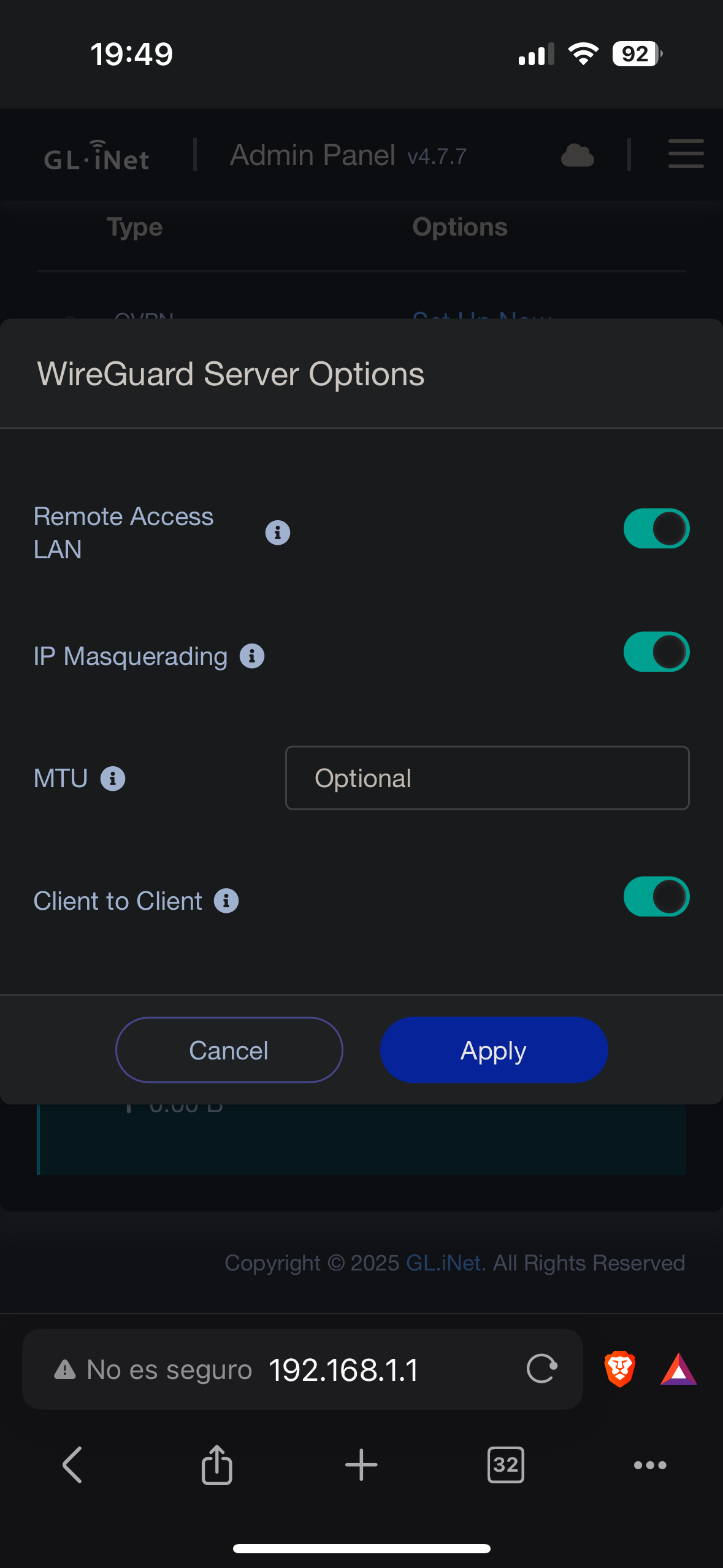

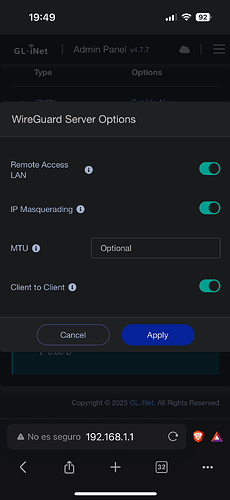

Hi, as you can see, I have everything activated as you mentioned, and I can't receive anything on my phone. I have a fixed IP address, and I had no problems getting it working on my previous OpenWRT router. I configured everything in the web interface, but I switched to OpenWRT to see if I could see any errors. I don't know where the problem could be. Any help would be appreciated.
