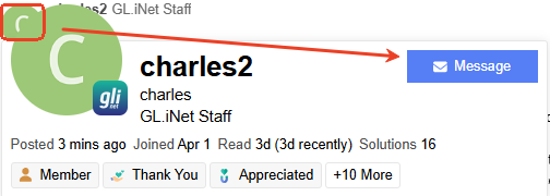

After collecting the command outputs, could you please send the results together with the system log to us via private message? This will help us further analyze the behavior when the issue occurs.
