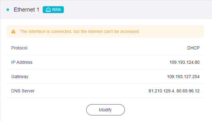

I tried to use the Flint3 router with my german ‘vodafonestation’ modem (router in bridgemode).
As I understand it, the modem is using dhcp and the values are looking good to me, but there is no internet access. Switching back to my old router is still working fine, so the modem itself is not the problem.

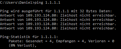

Sorry for the german screenshot. It means host unreachable. But shouldn’t this be directed through the gateway ip?
We’re not entirely sure what caused this issue, but the ping error appears to be routing related.

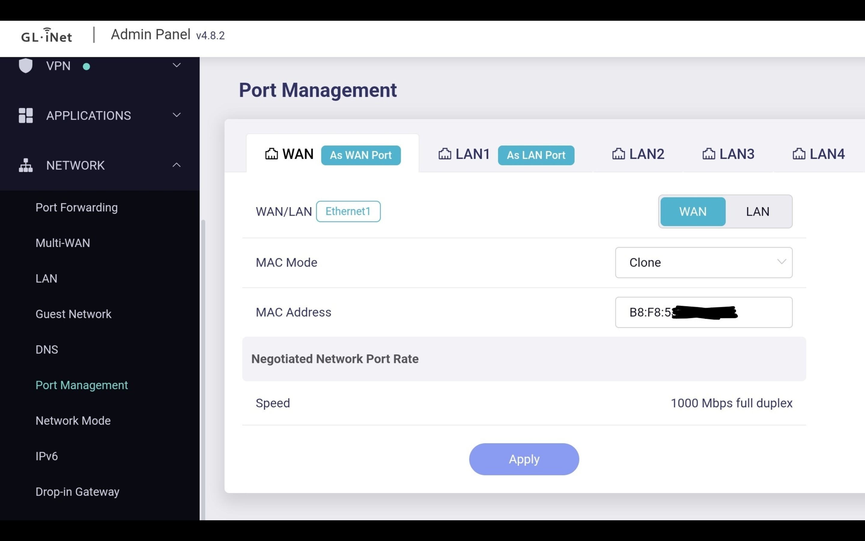

ISP’s often capture the MAC address of the router’s WAN port. The network may still be ‘looking’ for that stored MAC.
You can to clear it by unplugging your ISP modem for a few minutes or you can clone the MAC in the new router. I chose the second option. It allows me to swap back and forth between routers without issues.
Thanks, yes that’s the case, but I tried both things and besides that without that I didn’t get a public IP address assigned from dhcp it didn’t change anything about the not working internet access.

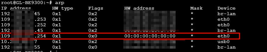

Based on our inspection, it appears that the ISP modem has assigned an incorrect gateway address or is failing to respond to ARP requests for some reason, preventing Flint3 from communicating with the gateway.
Please verify that the ISP modem's configuration is correct, or contact your ISP for further investigation.
Additionally, we've noticed that a device appears to be requesting the MAC address of Flint 3.
Is this the correct gateway?
Thanks for the investigation. I don’t think that my isp will be much help, they would very much like me to using their hardware exclusively.
Yes the second screenshot looks good. The provider is Vodafone.

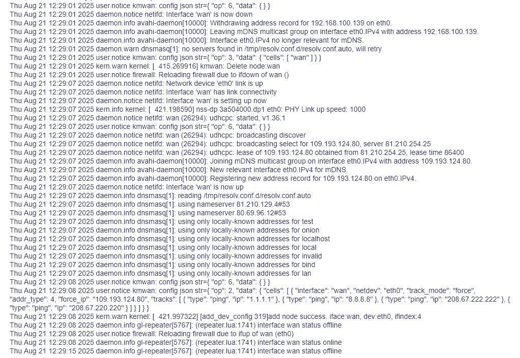

We want to capture packets to identify who sent the DHCP response which should make us be able to obtain the correct gateway address.
So that we can try adding a static ARP entry to see if that restores its functionality.
