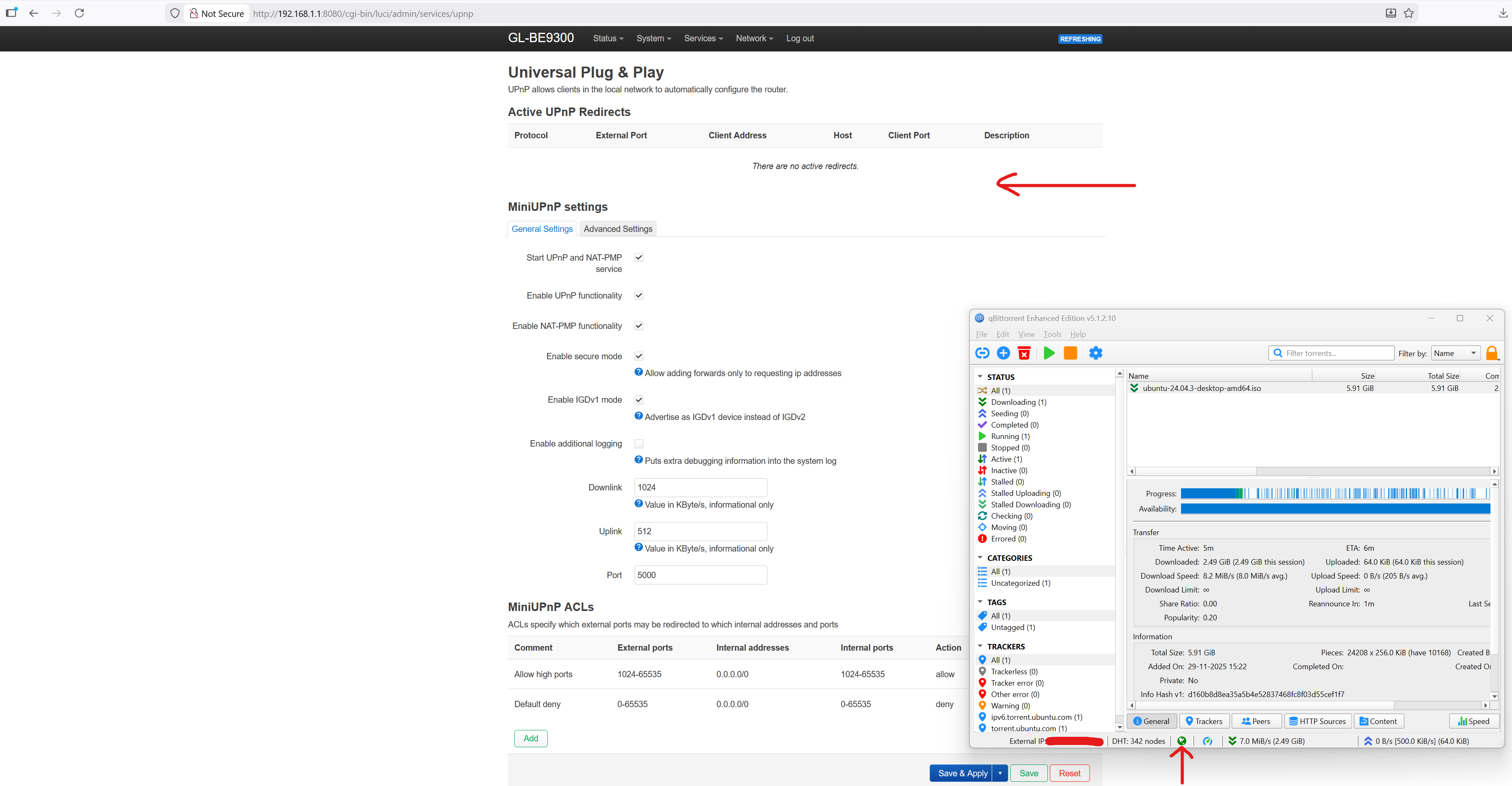

Installed firmware v4.8.3 on Flint3 , install luci-app-upnp
UPNP working , but luci not showing any active upnp status / active upnp redirects.
attached screenshot while qbittorrent downloading linux distro
Anything needs to be changed ?

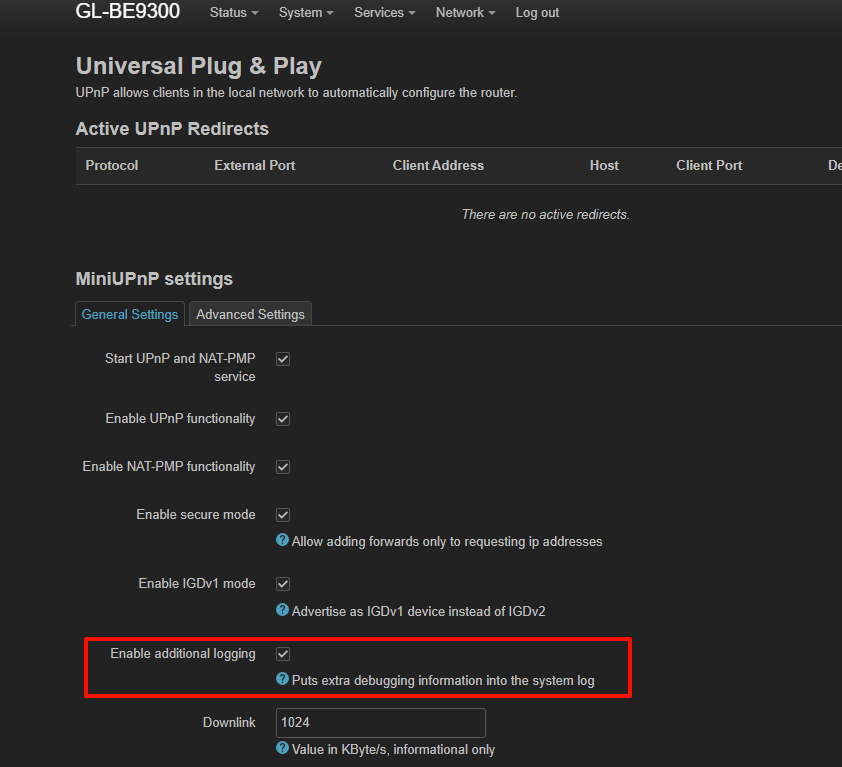

Based on our experience, UPNP compatibility can be inconsistent, so it is possible that it is simply not functioning as expected.
You may enable “Enable additional logging” in UPNP settings and review the Syslog for any successful configuration messages.

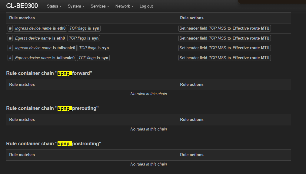

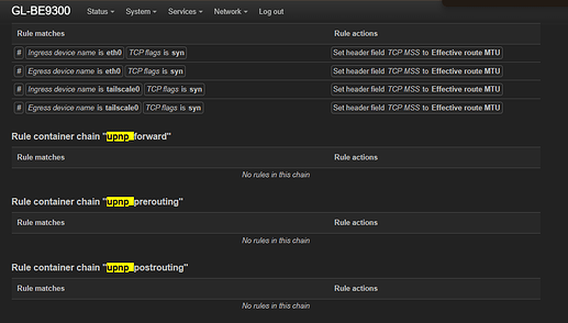

Also, verify whether the relevant firewall rules have been created under Status > Firewall.
