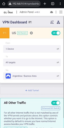

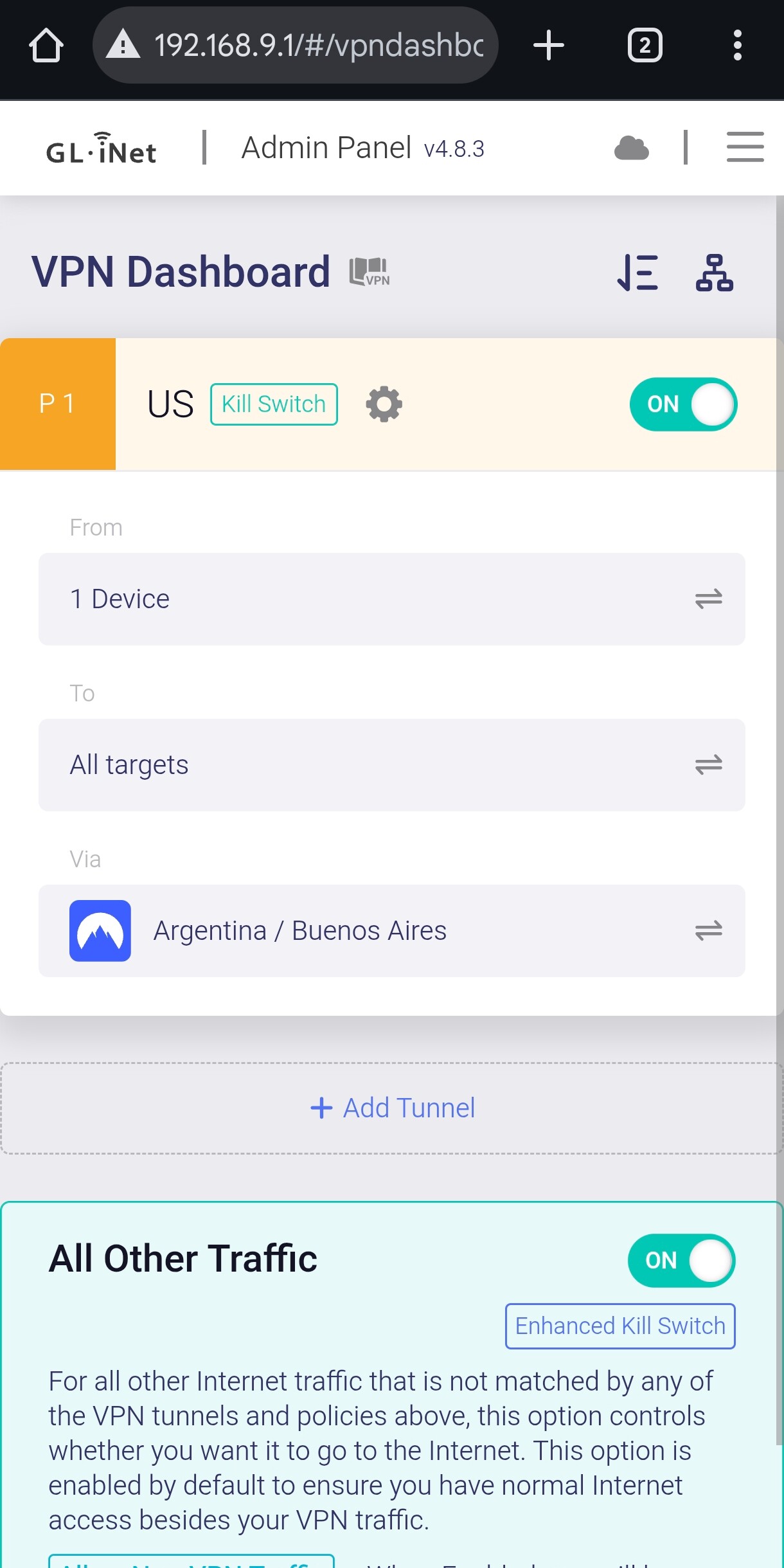

I’m trying to connect to NordVPN, but it doesn’t connect and I get that error. The indicator light stays yellow, but it never actually connects — it never turns green. I deleted everything and reinstalled the NordVPN credentials, but the same issue keeps happening. Thank you.
Awaiting for your comment.
