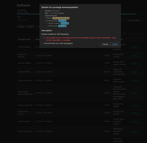

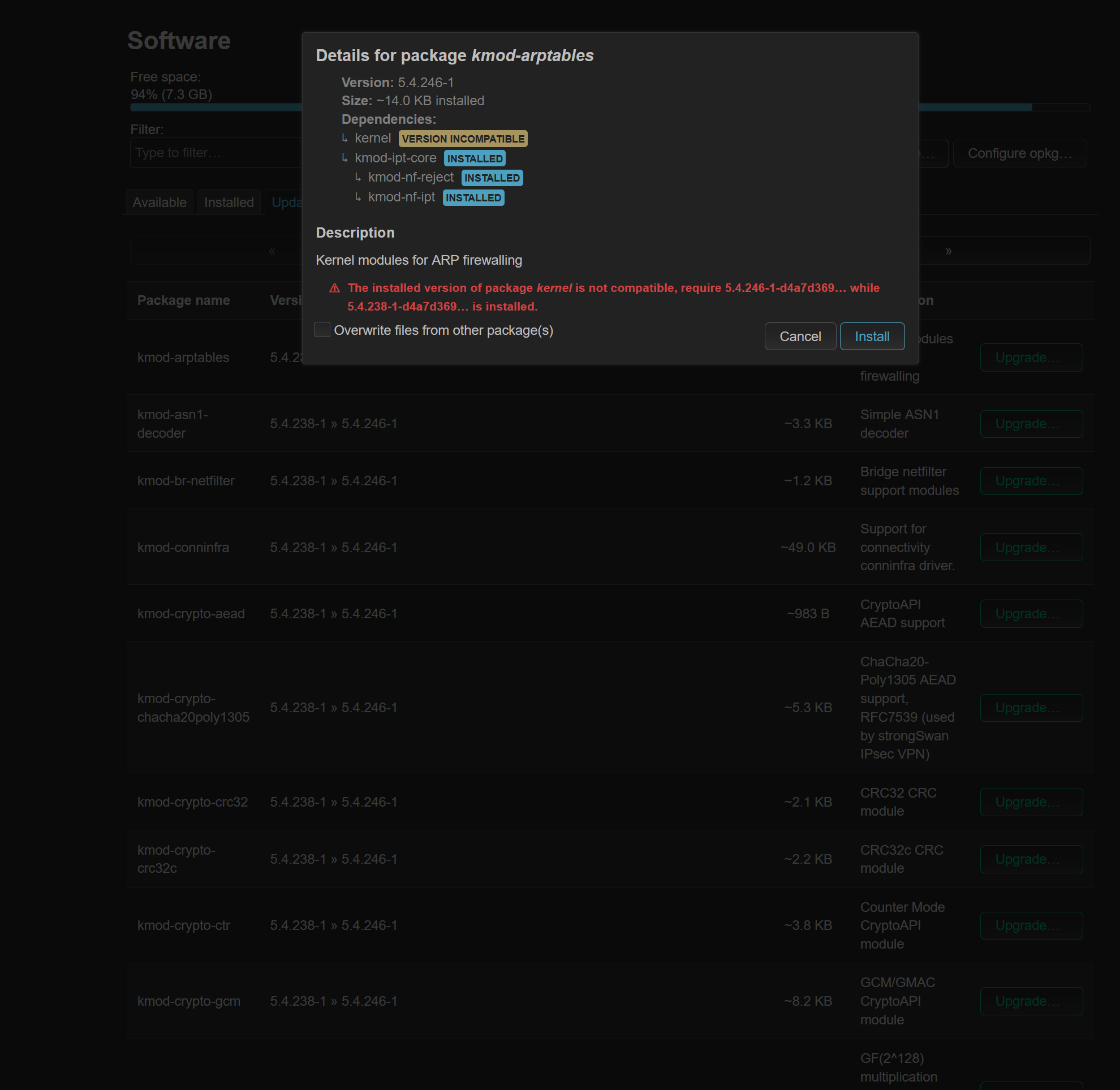

Before it was easy to install and setup, just had to do some trial and error with the settings but I didn't have problems installing it... What does this mean? Nothing else has changed other than the firmware (previous version was the latest stable).
There is a bunch of updates available for the installed packages on the device when I look into the software section in luci-advanced. However when I go to update them I am presented with the error that they are NOT compatible and it won't install. What a mess this is...
