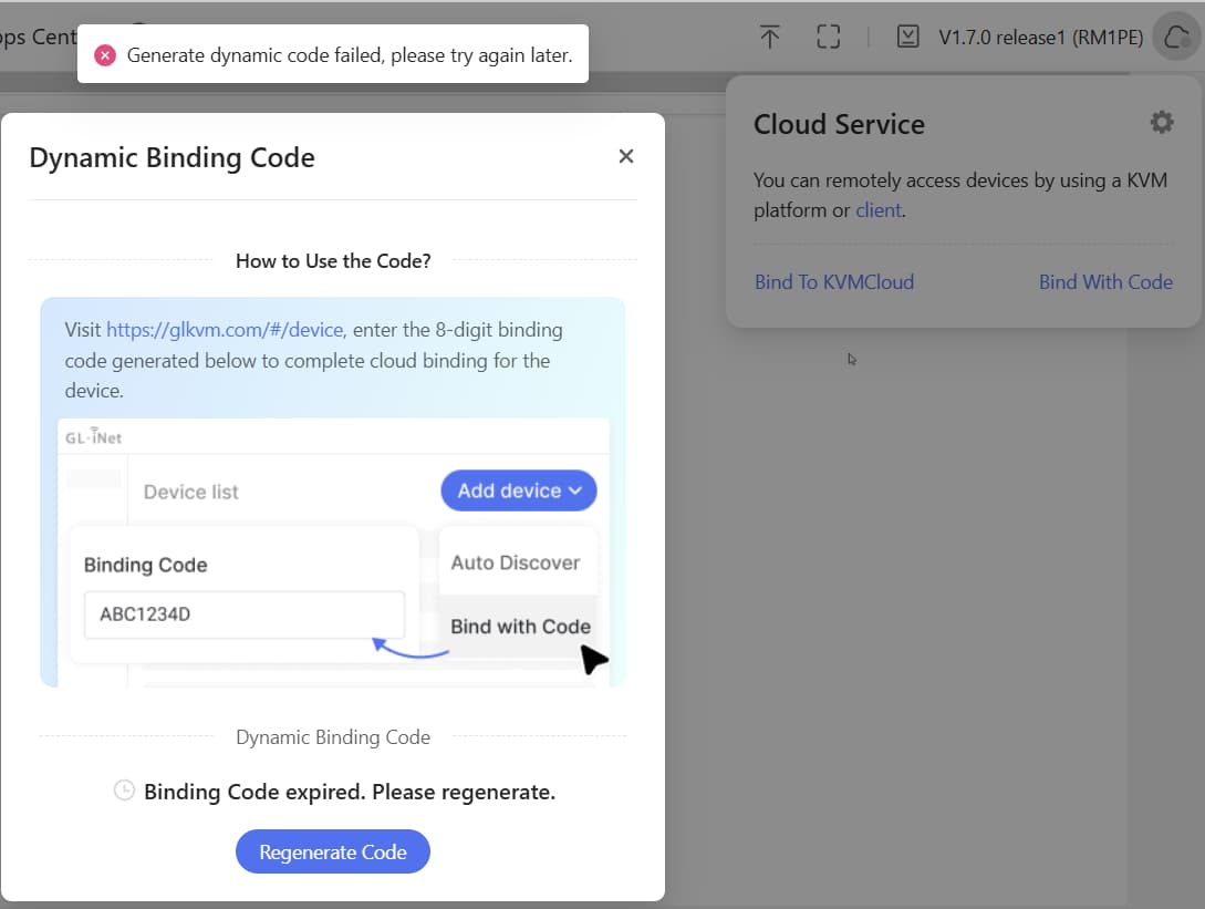

Generate dynamic code failed. Please try again later

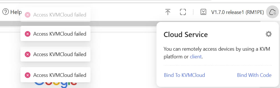

Just update my GL-RM1PE to the latest firmware WITHOUT keeping the settings. My device ended up showing as OFFLINE on cloud service and trying to bind with code gives me the above error! Choosing the option to bond to KVMCloud also produces another error with “Access KVMCloud failed”. Resetting device to factory default and reinstalling the firmware manually and I am still unable to connect to the cloud service. Never had this issue with previous updates or with my previous KVM model (GL-RM1). Any help or pointers here would be appreciated.

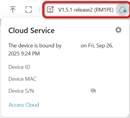

Downgraded down to 1.5.1 release 2 and the KVM connected automatically back to the cloud and showing up as online. Not clear as to what is going on with the new firmware release and whether anyone else has noticed the same issuse.

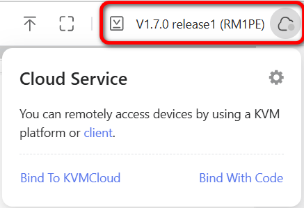

Tried a fresh upgrade again without keeping setting to no avail unfortunately. On old firmware cloud service appears to be working perfectly:
And IMMEDIATELY after upgrade, no connection at all with errors as shown:

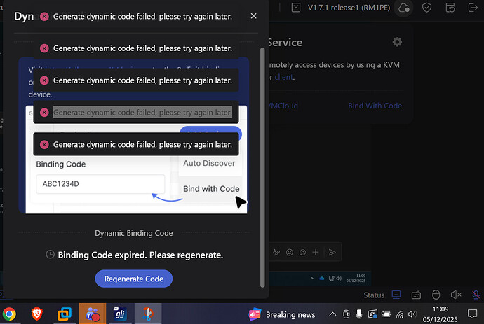

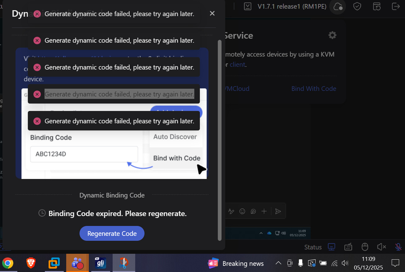

hi im having the exact same issue i was on 1.7 and now have upgraded to 1.7.1 but still cannot bind through the client app or on the cloud site.
In the client app the device shows up sometimes when trying to add and when i click bind it fails
Hi, could you please locally access to the RM1PE and export the log to us for analysis.
Also, please check if the device's DNS service is normal by ping google.com in Terminal and the time zone is correctly set.

I just install a GL-iNET RM1. I updated it to the last firmware 1.7.2
I can access it and my server without problem. But if I try to register it to the cloud, I get the same error `Access to KVMCloud fail’ and ‘ ‘Generate dinamic code failed, please try again later’
