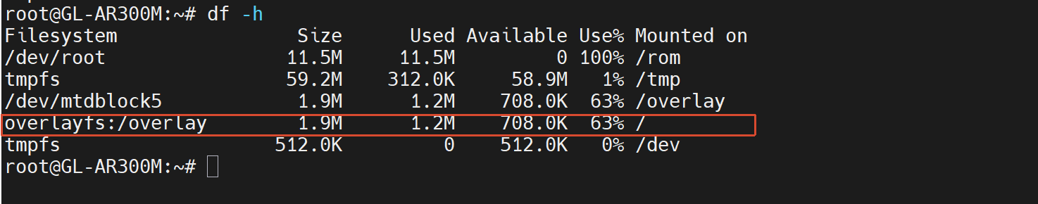

Please SSH into the router and run the following command to check whether the overlay filesystem is correctly mounted under the / path:
df -h
The output should look similar to this:
If the overlay is not mounted correctly, please try reflashing the firmware through U-Boot according to the guide below to repair the issue.
