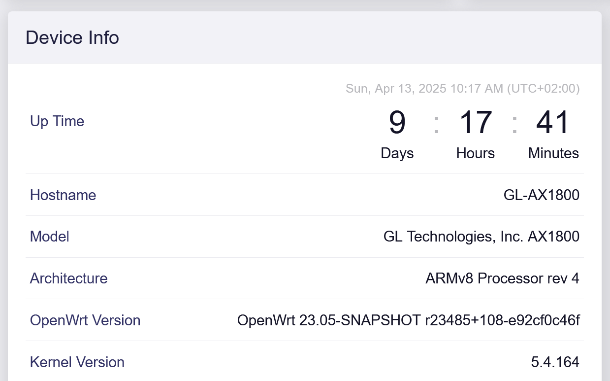

I have network acceleration enabled and no issues on the RC version
