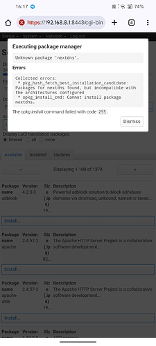

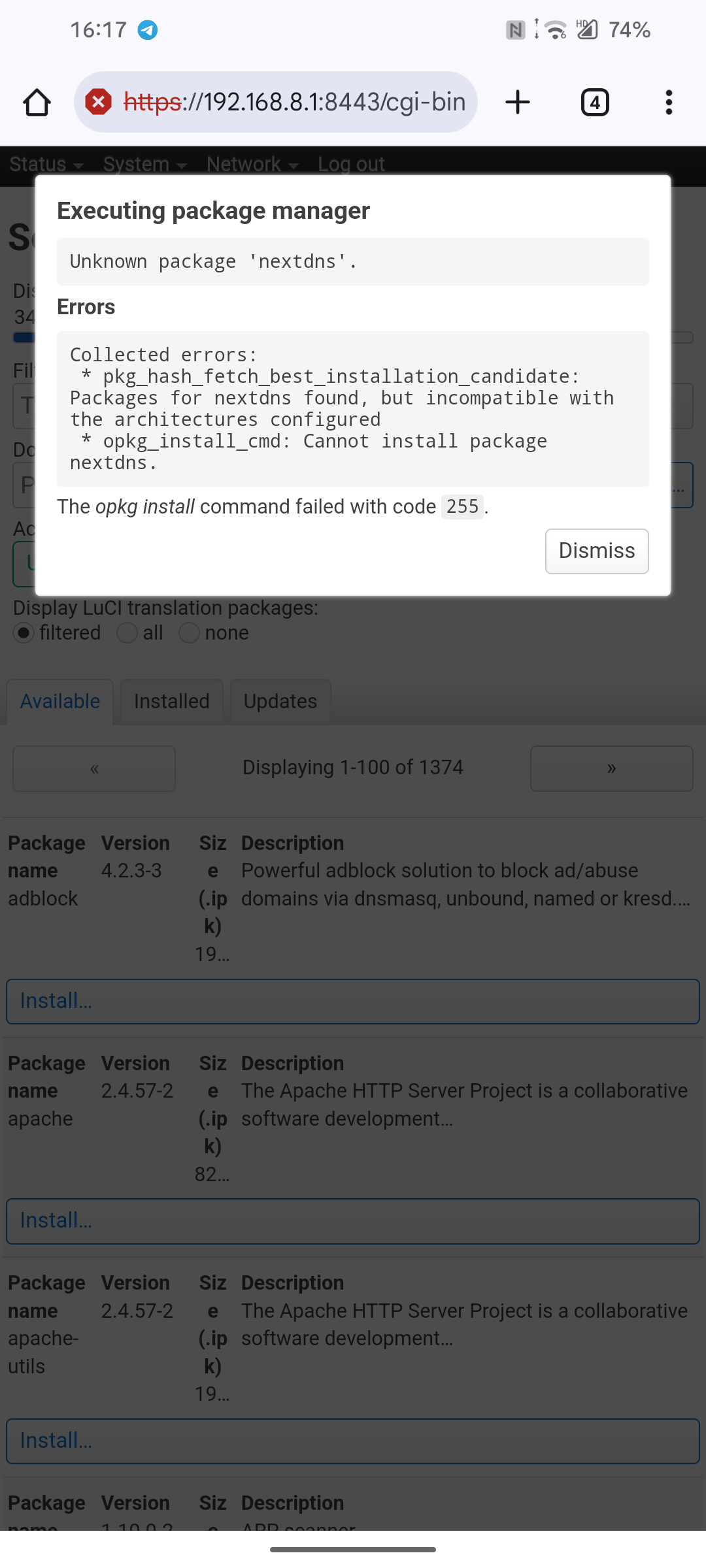

I am trying to install NextDns package via SSH command but it fails. Looked into lucy software repositories, also didnt find Nextdns. Tried manually add installation package in lucy, downloaded many files but all time gets in return error as installation file is for diffrent infrastructure.
anybody knows what to do?
I can see in Router DNS setting NextDNS but cannot assign my ID from Account as interface says nextdns needs be installed. I am able to use only not configured public DNS filtering.

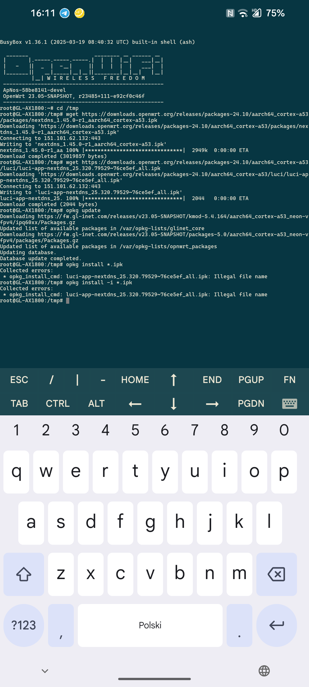

It is because the repo from gl inet does not have this package.
I would advise to first make a backup of the configuration, because I don't know what else the luci app depends on, it could potentially break openwrt by downloading a core dependency.
so you have to login via ssh.

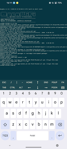

Then type:
cd /tmp
wget https://downloads.openwrt.org/releases/packages-24.10/aarch64_cortex-a53/packages/nextdns_1.45.0-r1_aarch64_cortex-a53.ipk
wget https://downloads.openwrt.org/releases/packages-24.10/aarch64_cortex-a53/luci/luci-app-nextdns_25.320.79529~76ce5ef_all.ipk
opkg update
opkg install *.ipk if that doesn't work try using opkg install -i *.ipk
In order to have it work correctly you need to disable stubby by typing:
/etc/init.d/stubby stop && /etc/init.d/stubby disable
If you login again in luci a services tab appear with nextdns settings, no need for the external curl script :wink:

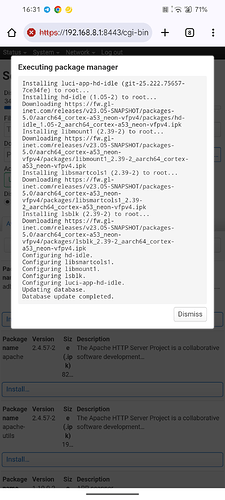

Thanks for help, unfortunately it didn't work, still have an error….I did try install this two files with NextDns via Lucy…error like on the screenshot..

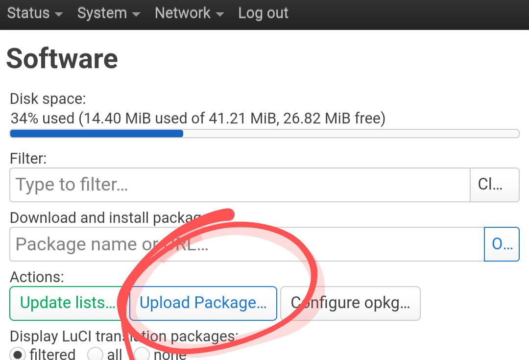

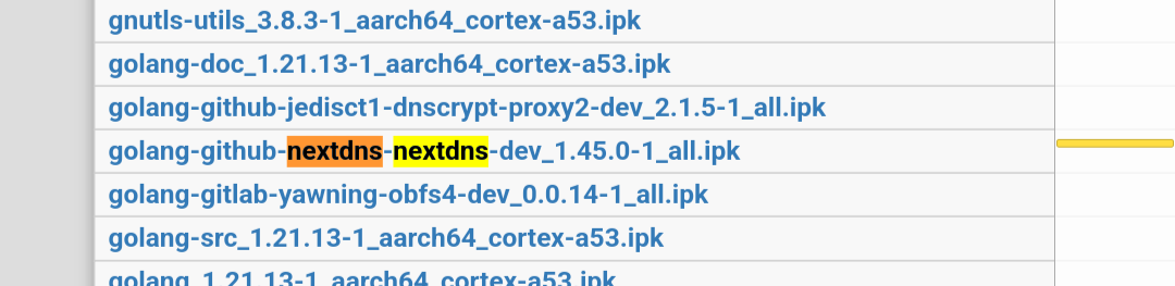

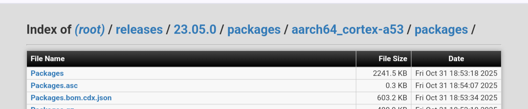

Update:….I was able to install NextDns via Luci upload package settings, found I think correct file here :
but installed only one file which is :
golang-github-nextdns-nextdns-dev_1.45.0-r1_all.ipk

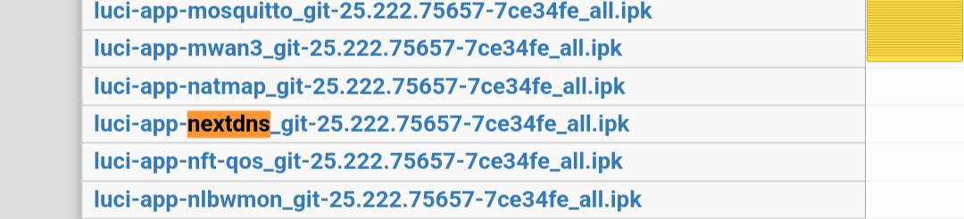

Another one which :
luci-app-nextdns_git-25.222.75657-7ce34fe_all.ipk
I have error during installation.
Do I need to have installed the 2nd file for Luci also?
