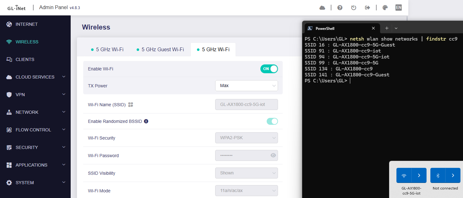

We tested this locally on the AX1800 running v4.8.3, but were unable to reproduce the issue.
A third SSID can be enabled simultaneously, and devices can connect and access the network normally.
You may want to double-check and try using the following configuration:
config wifi-iface 'wifinet0'
        option device 'radio0'
        option network 'lan'
        option mode 'ap'
        option ssid 'GL-AX1800-cc9-5G-iot'
        option encryption 'psk2'
        option key 'goodlife'
        option isolate '0'
        option ifname 'wlan1-2'
        option disabled '0'
config wifi-iface 'wifinet1'
        option device 'radio1'
        option mode 'ap'
        option ssid 'GL-AX1800-cc9-iot'
        option isolate '0'
        option ifname 'wlan0-2'
