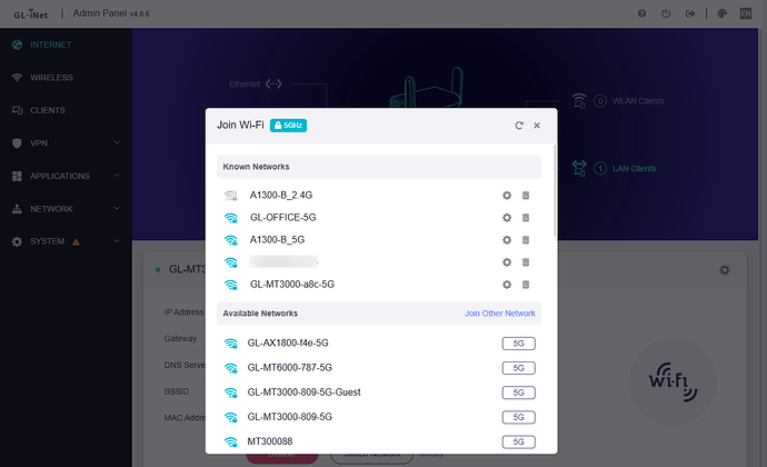

Hi @bruce, you have to click in the window before and select 5G only instead of Auto.
I hope the screenshot explains the step before.
Then you try connect to the router in repeater mode again, which will most likely fail. Going back then to Auto is not possible. Also deleting the setting and the saved router was not possible for me.
