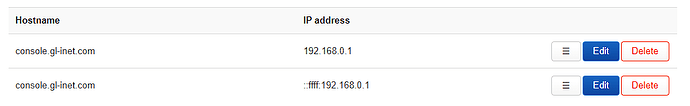

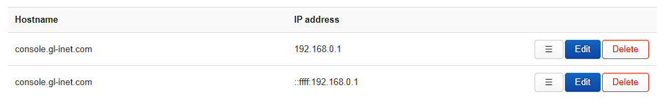

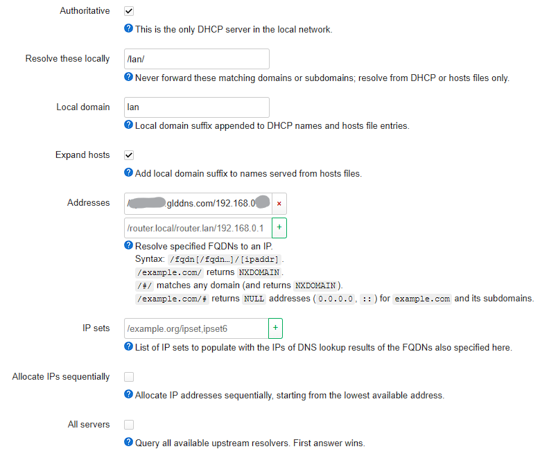

I’ve checked LuCI as requested — attaching screenshots of the Hostnames and DHCP & DNS configuration pages.
  • Hostnames: only standard entries for console.gl-inet.com (IPv4 + IPv6).
  • DHCP & DNS: default settings, no manual mappings or FQDN rules related to Google.
  • The only custom “Addresses” are my router’s DDNS hostname (???????.glddns.com/192.168.0.??) and local alias (router.local/192.168.0.1).
  • “Resolve specified FQDNs to an IP” is using the default /# → NXDOMAIN rule.
Everything looks standard; there’s no sign of local overrides or configuration errors.

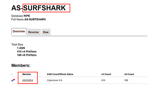

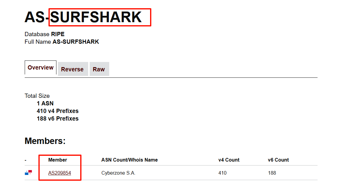

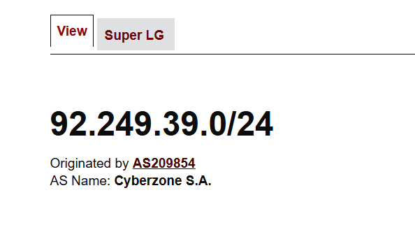

May we know are you using Surfshark VPN?
After checking this IP's information, it appears to be an address associated with Surfshark VPN and may be related to its activities.
Also, have you enabled the Network - DNS - "Allow Custom DNS to Override VPN DNS" option to bypass the VPN DNS?

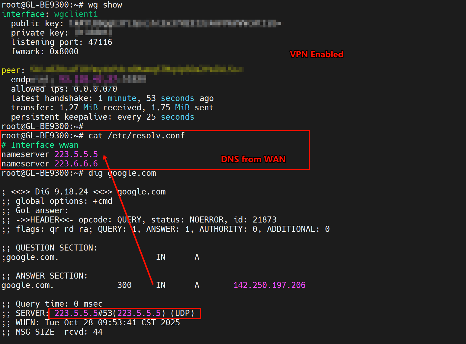

If no changes were made to Network → DNS (keep Automatic mode) before enabling AdGuard Home, then this is the expected behavior.
When “Allow Custom DNS to Override VPN DNS” and “AdGuard Home Handle Client Requests” is disabled,
the router will set the VPN-provided DNS servers as the upstream DNS server of dnsmasq which also provides DNS service to LAN clients.
That’s also why the command
dig @127.0.0.1 google.com +short
returns a VPN DNS resolution result — because 127.0.0.1 corresponds to dnsmasq, which in this case uses the VPN’s DNS servers.
If you want LAN clients to use ADG Home instead of those provided by the VPN, simply enable “Allow Custom DNS to Override VPN DNS” or "AdGuard Home Handle Client Requests".
