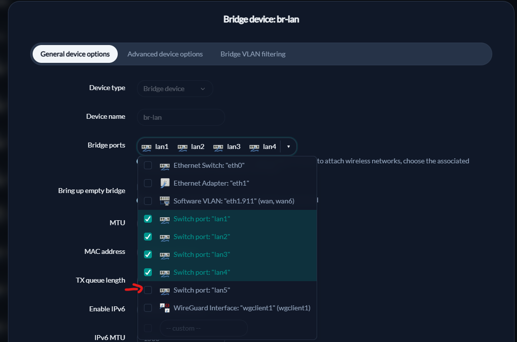

This is how I did on mine. Flint2 running 4.9.0-op24
Remove LAN4 from here:

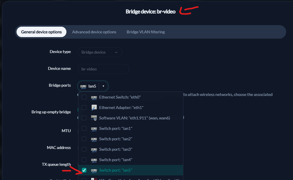

Add it to br-IoT
ignore the br-video in the photo :slight_smile:

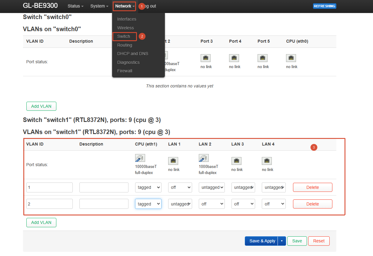

Thanks. I'd read another two or three threads with similar questions, and everyone said the same thing you did, but I'm in a situation where I don't have any ports selected—I just have a VLAN switch:
The BE9300 uses a swconfig-based switch architecture, rather than DSA.
Therefore, the configuration steps are as follows:
  1. Go to LuCI → Network → Switch and adjust the LAN 4 port settings:

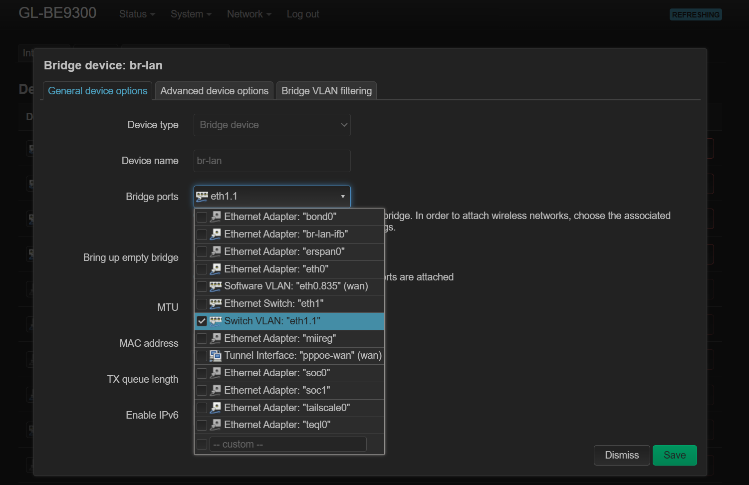

    Additional note: The relationship between the port labels on the BE9300 chassis and the ports shown in the Switch Configuration page is as follows:

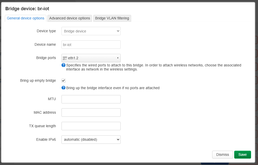

  2. Go to Network → Interfaces → Devices and add eth1.2 to br-iot:
    (In eth1.x, the value of x should match the VLAN ID configured in the previous step.)
  3. Save and apply the changes.
  4. After that, it should work as expected.
thank you will, works perfectly!
