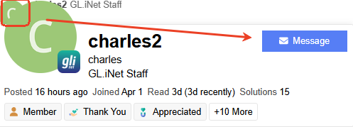

Could you please export the system log from the Flint 3 after the issue occurs, and send the following information to us via private message:
/tmp/lan-port-test.pcap
The exported system log
The screenshots taken before and after moving the switch
Thank you for your understanding and cooperation.
