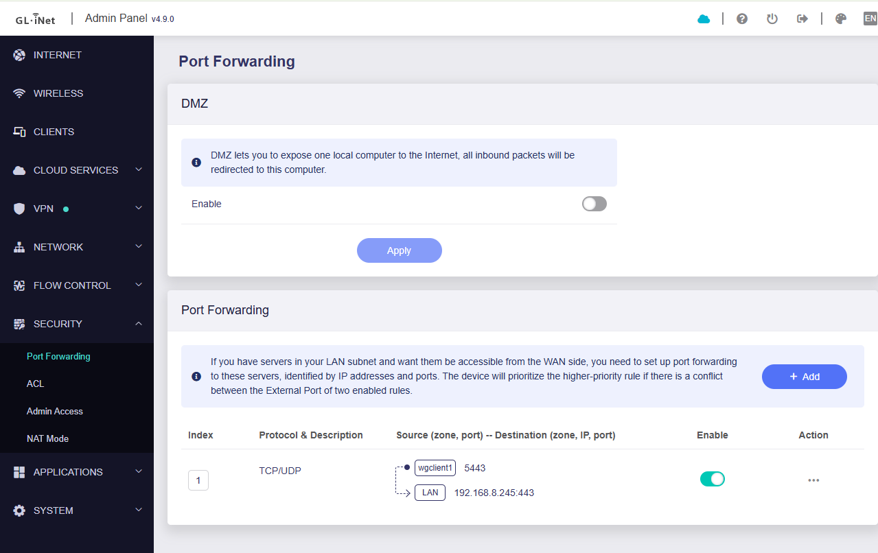

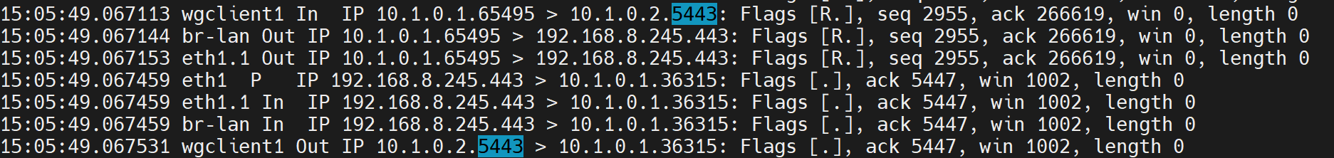

We tested locally using BE9300 v4.9.0 Release 5, and forwarding from the WireGuard client to LAN devices appears to be working correctly.
Configuration:
Packet capture:
As others have suggested, this may be related to preserving the configuration during the firmware upgrade.

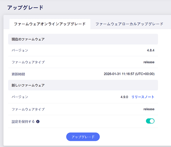

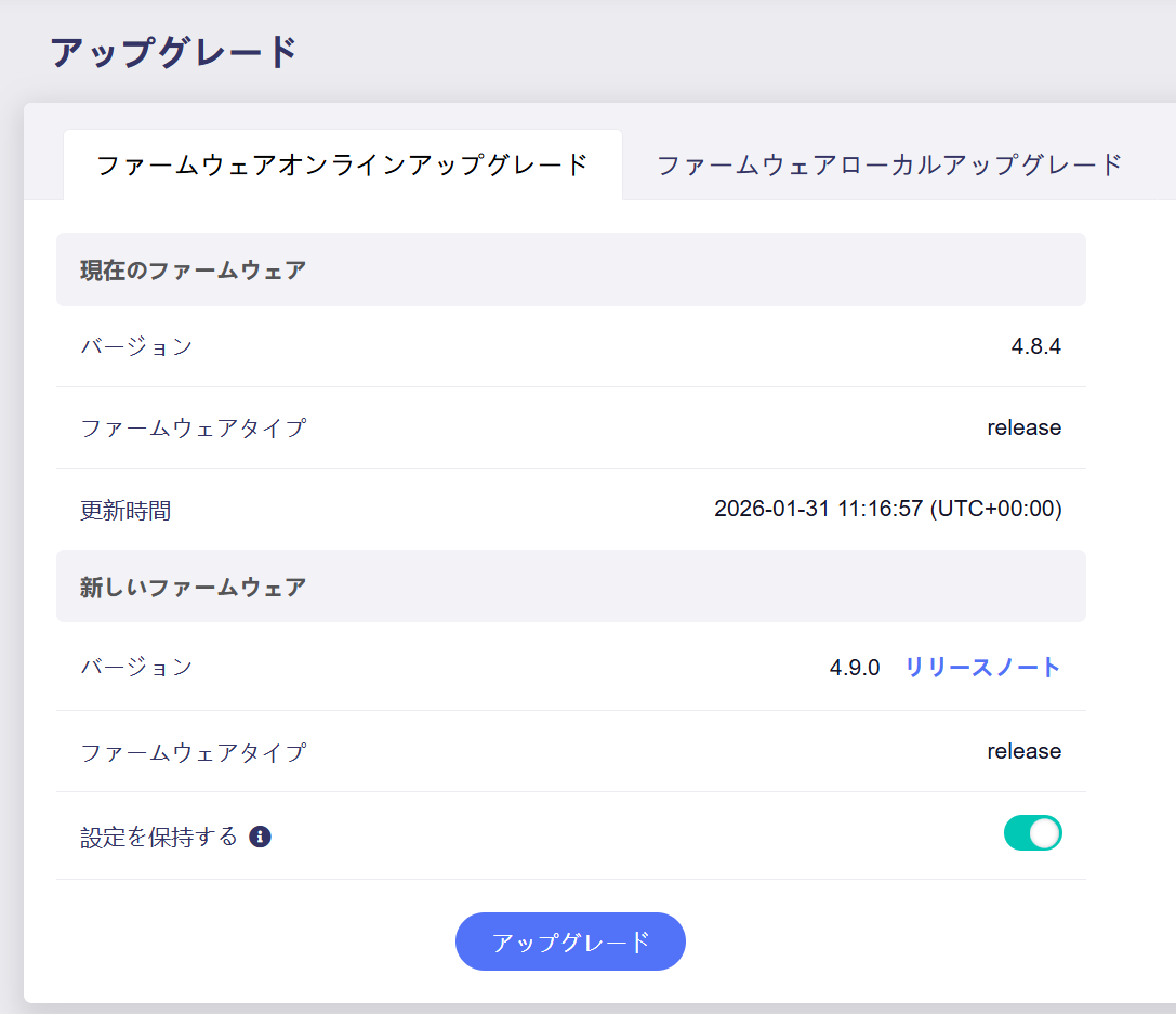

I upgraded from v4.8.4 to v4.9.0 with "Keep settings" enabled, as shown in the attached screenshot (dialog.png). The UI is in Japanese, but the "Keep settings" toggle is ON.
Just to clarify: I configured port forwarding using the GL.iNet web GUI (not LuCI). The rules were visible and enabled in the GL web GUI. I also tested deleting and recreating the port forwarding rules via the GL web GUI, as well as rebooting, but the issue persisted.

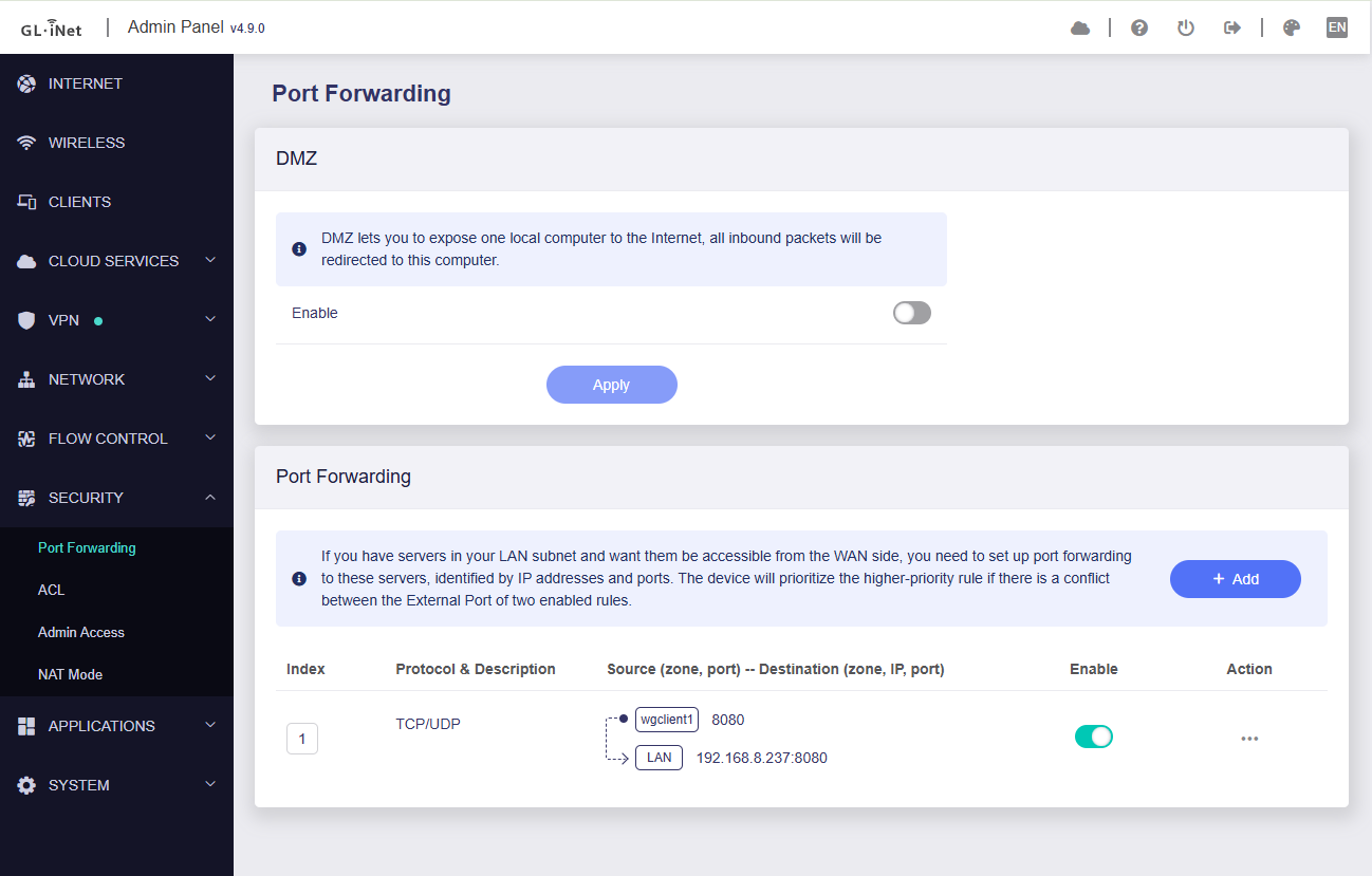

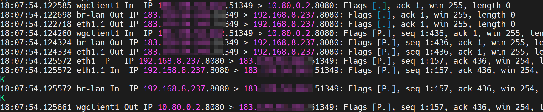

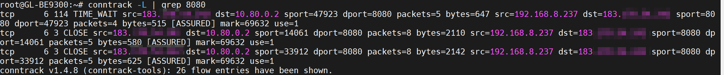

We deployed the same test environment, and port forwarding appears to work correctly when upgrade frorm v4.8.4 to v4.9.0 Release 5 on BE9300, even if the WireGuard server is configured without SNAT.
From the packet captures, the traffic flow behaves as expected:
WG Server:8080 → WG Client:8080 → LAN:8080
The conntrack entry also looks correct. The mark value 69632 (0x11000) indicates that both the VPN and port forwarding flags have been applied successfully.
On v4.9.0, we introduced a new kernel module to handle port forwarding in order to provide more consistent behavior in certain scenarios.
As a result, port forwarding rules are no longer implemented through the firewall 3/4. Therefore, you will not see corresponding firewall rules in LuCI, nor is any additional firewall configuration required.
Would you have a chance to check the following suggestions?

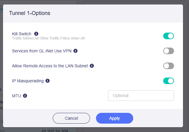

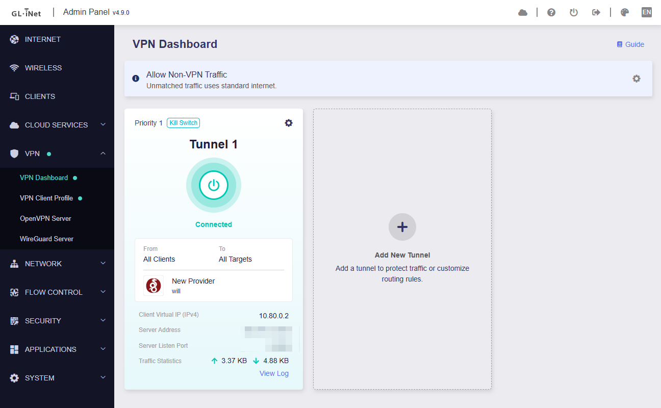

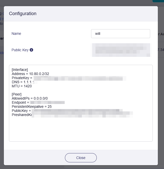

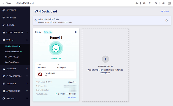

Our local configuration is as follows:
WG Profile:
VPN Dashboard:
Port Forwarding:
Perhaps you should investigate why the firewall is not applying the VPN mark (0x1000):
