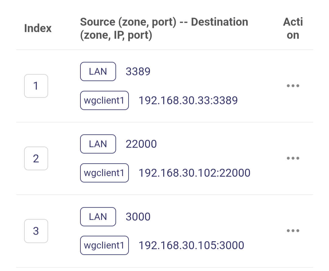

Hi , after upgrading to the latest version ( it says 4.0 1000release ) , my port forwarding settings stopped working.
I have wireguard tunnel and port forwarding set from LAN to wgclient1 . This was working before the upgrade but it's not anymore.

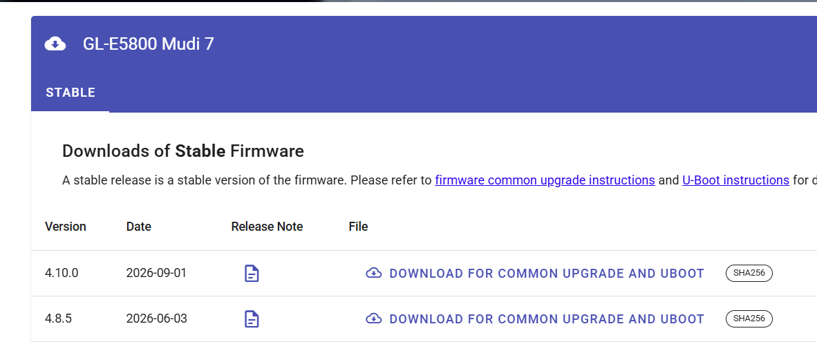

Is it possible to downgrade to fix this ?
Hello, what's the firmware version of the router before the upgrading?
I believe it was the 4.8.5 , i was only using the stable OTA releases.
Can I just use the “Firmware local upgrade” to downgrade to 4.8.5 downloaded from the download center ?
What's your port forwarding rule? Can you share a photo to check?
Additionally, please execute the following command in the ssh terminal and share the output with us. Thanks
Here are the port forwarding rules :
Can you please share the command i should run ? Thank you.
Is it possible to downgrade by uploading the 4.8.5 firmware ?
Sorry, forgot to add it. Please check the output of this command:
cat /proc/port_forward_rules
Downgrading might help to fix it

Downgrading to 4.8.5 fixed the issue.
Thanks for the details. In that case, this may have been a Beta 4 issue.
