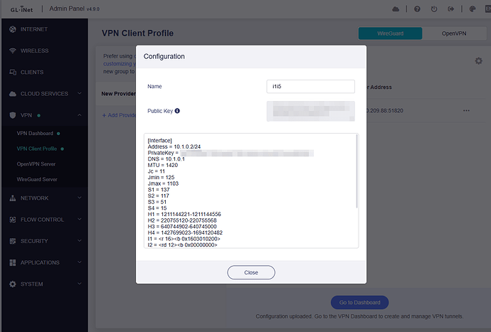

The problem is with importing an AmneziaWG 2.0 client configuration into the GL.iNet web UI.
I go to:
VPN Dashboard / VPN Client / WireGuard / Add Profile / Upload Configuration
The file uploads successfully, but after clicking Apply it shows only:
Failed
No detailed error is shown in the web UI.

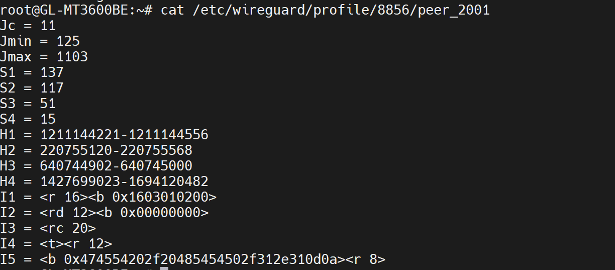

Please refer to our reply below:
  1. We tested locally using MT3600BE v4.9.0 beta2, and it seems that an AWG 2.0 configuration file with the I1–I5 parameters can be loaded and used normally:
  1. Please refer to our documentation to learn more about the current support status for AWG parameters:
    AmneziaWG Obfuscation - GL.iNet Router Docs 4
3, 4, and 5.
You can SSH into the router and then modify the files under /etc/wireguard/profile/ to adjust the AWG parameters:
After that, you can enable it directly from the web interface.
That helped! Thank you very much!
I had the same problem with applying AmneziaWG config to Beryl 7 as a client.
I had two different configs - one would work just fine, another would drop the S4 from the list while importing and failed to connect afterwards. Editing via UI would not allow me to insert the S4, weird, definitely a bug.
I used the above direct edit suggestion and injected the S4 directly and it started connecting.
Could you please share the AmneziaWG profile that is not working properly with us so we can check it?
You can hide sensitive information such as the server address and public/private keys, or send the profile to us via private message.
