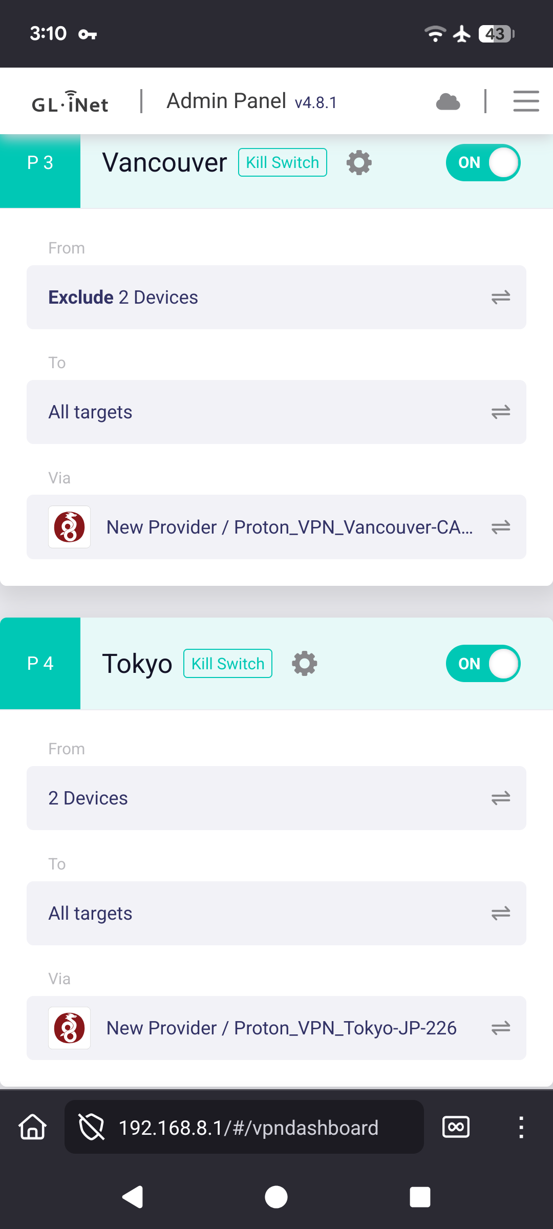

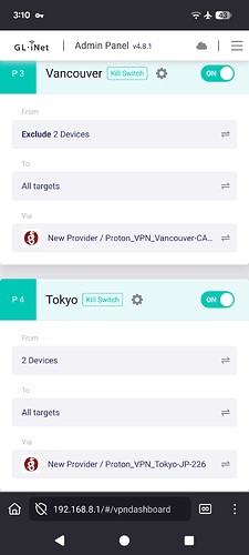

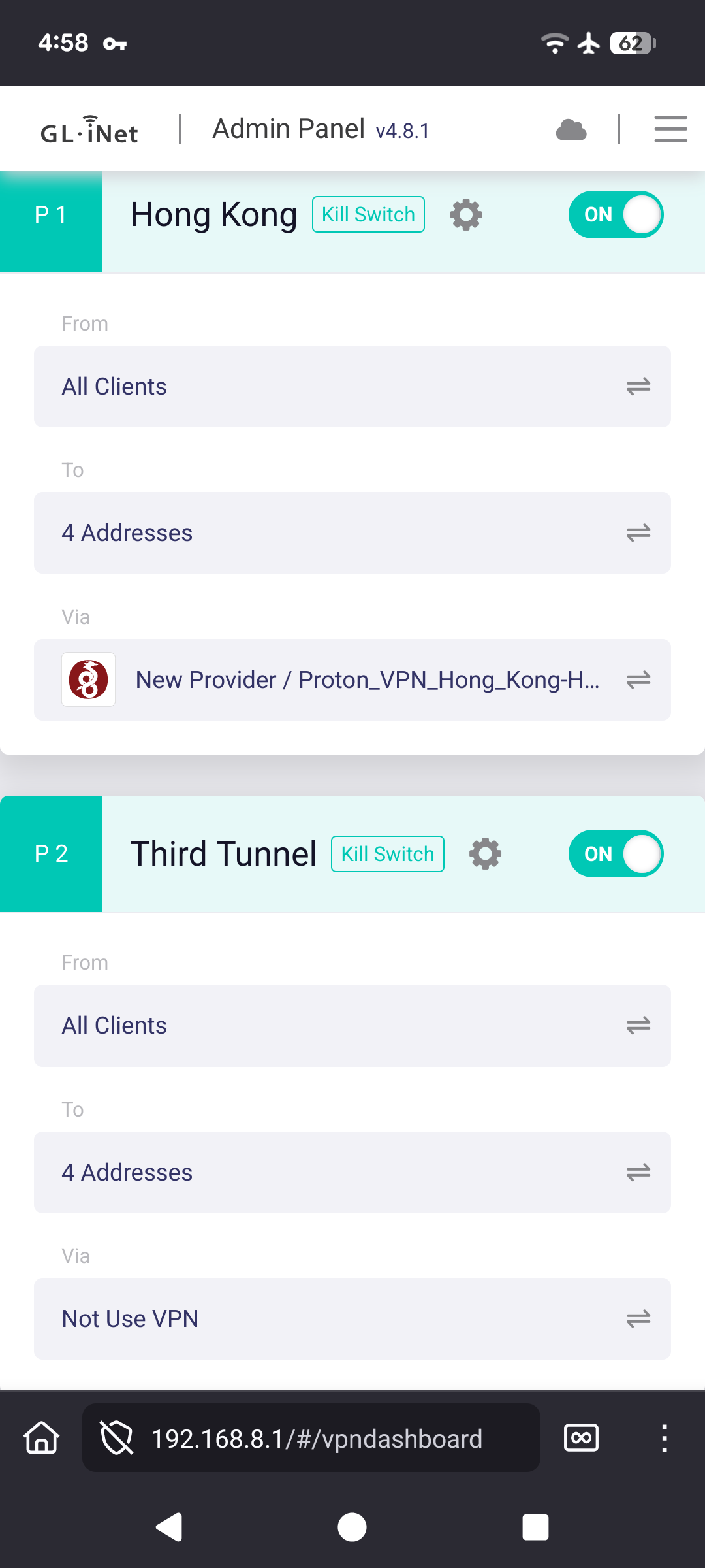

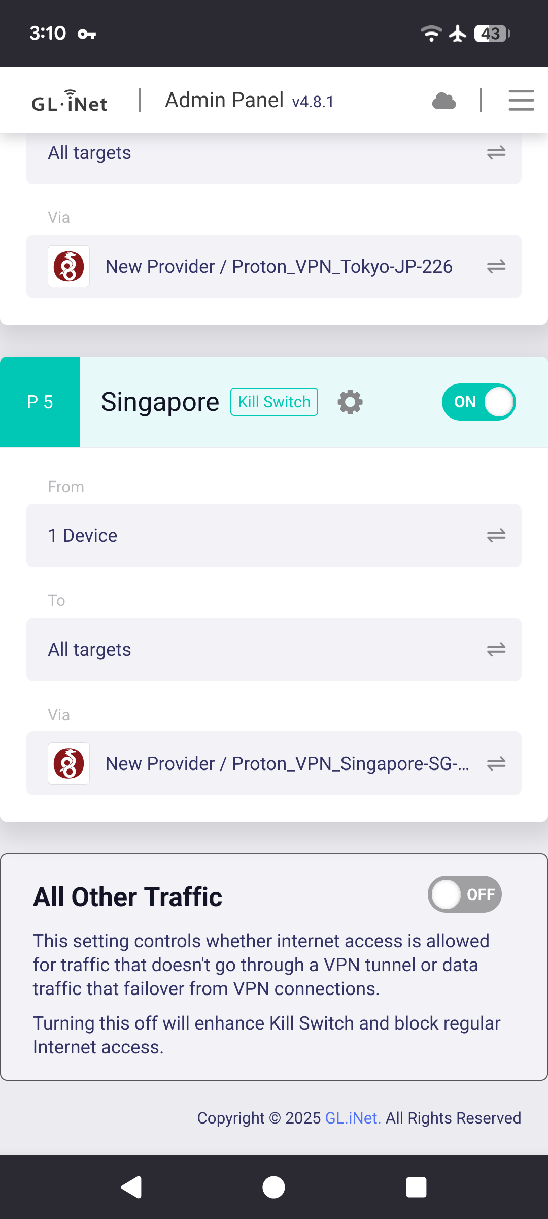

I'm definitely doing something wrong because this isn't working. Excuse the naming of the tunnels as I was moving and playing around with the priority of the tunnels. The difference between my configuration and the one from @will.qiu is that I specify “all clients” instead of a specific client. I set four domains that should all be directed to use a Hong Kong VPN and four domains that shouldn't use a VPN. It seems like only the four domains not using a VPN are working while the previous four domains aren't being directed to Hong Kong. What am I doing wrong? I even added “IP.me” to the Hong Kong tunnel, but it showed my current IP and geographic location.
@will.qiu @bruce
I can't seem to get the screenshots in order, but I think you'll know by looking at them which order the tunnels are actually in.
There are lots of questions spanning three posts and I’m hoping you guys can lead me to a resolution as I've tried every single possible combination I can think of and nothing works to my satisfaction.
As you can see in the first screenshot, I want all clients to use the Hong Kong VPN if they connect to 5 specific addresses. There are also 17 certain addresses that I don't want to use any VPN since they don't play nicely with VPNs. So these addresses (mainly banks and telecommunications) will directly connect to the internet.
For the third tunnel, I want all but two devices to connect to a VPN in Vancouver. “All targets” is selected under “to”. Given what you said about priority, I put tunnel 1 first since it has a smaller domain list followed by tunnel 2. My understanding of how this should work is that the 22 specified addresses will either connect to a Hong Kong VPN or not use a VPN. Any other traffic except for two devices will be directed to the Vancouver VPN. Yet, it doesn't work. Currently, it seems like all traffic are routed to the non-VPN tunnel.
For tunnels 4 and 5, I named them Tokyo and Singapore and specified the devices that will use those tunnels. “All targets” is selected and I can confirm this does work.
Very frustrating and I'm hoping someone here can help me get this to work.

I just did what you suggested. I cleared the address list. I put in a different IP identifying site for the first two tunnels. I was stunned that both returned the same IP as tunnel 3! When I disabled tunnel 3 to see what happened, I lost internet. Clearly, there is something wrong. Either it's a user error or there is something wrong with the firmware.
IDK how you can do this all on a phone. Your tablet should have a portrait mode, no? Post a screenshot of the VPN Dashboard using that. Let's see the whole setup.
Seems self-explanatory and screenshots look similar to the one @will.qiu posted. I did exactly what you suggested. Not sure why I need to show a screenshot from the computer.
If you are currently using AdGuard Home and have the option “AdGuard Home processing client requests” enabled, please disable it.
When this option is enabled, domain-based VPN policies will not take effect.
Oh, I see. I'll give it a try and see what happens. If I disable it, what are the implications for my DNS settings inside AGH?
