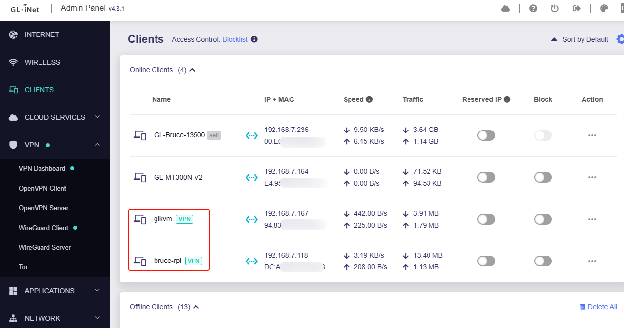

I would like to clarify that, for example the Client A and Client B are both in a VPN rule "From - Specified Devices".
When this VPN tunnel (rule) is enabled, can Client A not access Client B through LAN IP?
RPi and KVM in one VPN rule, and no issue.
Bruce_2025-08-25_11-36-40
