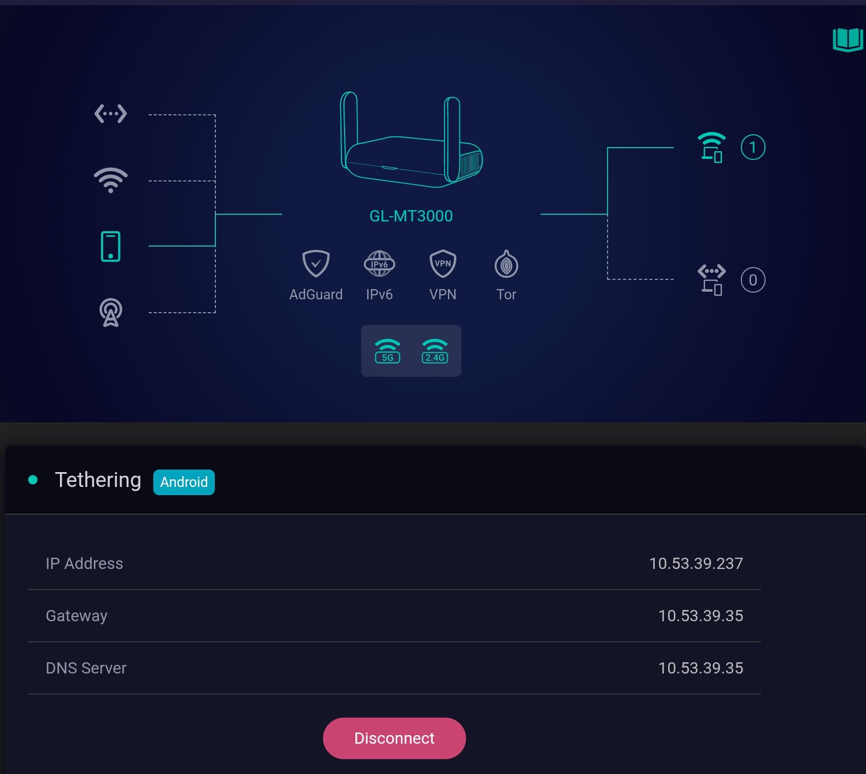

Hello GL.iNet Support Team,
I am writing to report a significant performance issue with USB tethering on my Beryl AX (GL-MT3000), currently running firmware v4.8.1.
Setup:
  • Router: GL-MT3000 Beryl AX, firmware 4.8.1
  • Phone: Xiaomi Redmi Note 12 Pro 5G (Android, USB mode set to 'Share connection via USB' / RNDIS)
  • Carrier: Movistar Spain, 5G connection
  • Cable: AUKEY braided USB-A to USB-C data cable
  • Flow Offloading: both Software and Hardware enabled
Test results (Speedtest.net from a wired LAN client):
  1. Direct 5G speed on phone (baseline): ~380 Mbps down / ~12 Mbps up / 28ms ping
  2. USB Tethering via Beryl AX: ~4-5 Mbps down / ~10 Mbps up / 29ms ping
  3. WiFi Repeater 5GHz via Beryl AX: ~536 Mbps down / ~27 Mbps up / 27ms ping
As you can see, USB tethering delivers only 4-5 Mbps download, while WiFi Repeater on the same device and connection delivers 536 Mbps. The phone itself confirms the 5G connection is healthy.
Troubleshooting already performed:
  • Tested multiple USB cables
  • Verified USB mode is set to RNDIS/tethering (not file transfer)
  • Confirmed router detects phone correctly as usb0 interface
  • Enabled both Software and Hardware Flow Offloading
My question is: is this a known firmware limitation with Android USB tethering on the GL-MT3000, or could this indicate a hardware issue with the USB port? I have seen similar reports on your forum dating back to 2023 with no confirmed fix.
I would appreciate any guidance or confirmation of whether this will be addressed in an upcoming firmware release such as v4.9.
Thank you for your support.
I'm on firmware 4.9
My port works just fine, using a generic brand data USB C-C with a C to A adapter I get 100down, 20 up.
Phone ISP (T-Mobile) > Samsung A53 Tether Mode > USB C to USB C-A Adapter > MT3000 > Speeds what I get from isp match. well within margin, I normally get average 100/20.
