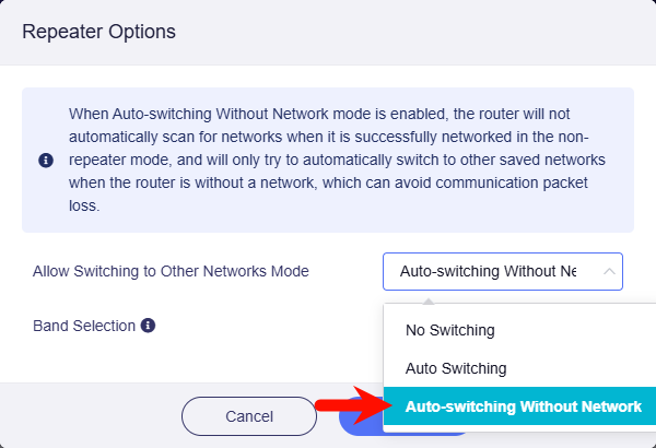

Please try to select this option in repeater options:

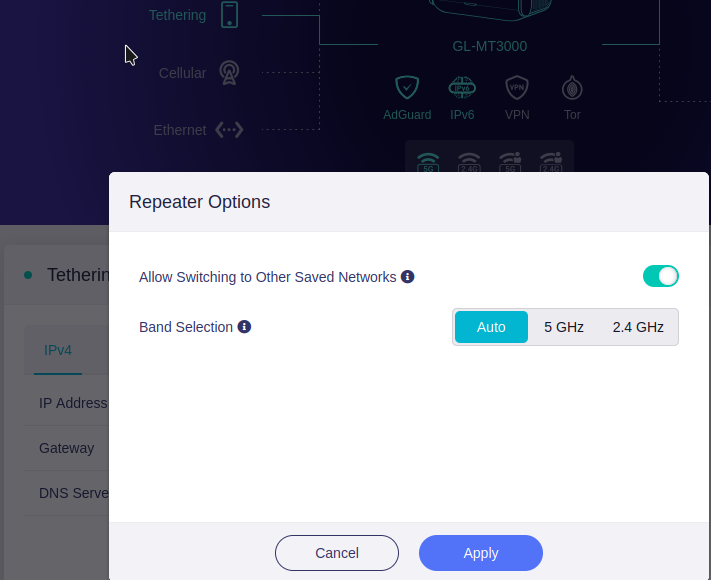

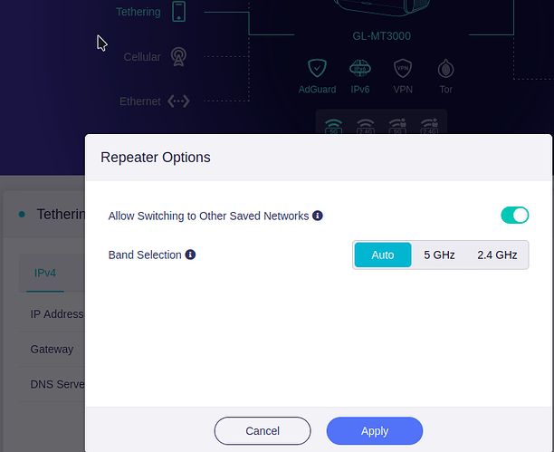

thanks for your reply.
I’m not seeing that option on my model.

Thank you for your feedback and testing!
The MT3000 stable firmware may not yet support for this.
Please upgrade to the firmware v4.8.3 (snapshot) to get this feature:
Edit:
Sorry, this new feature option doesn't seem to be supported on the MT3000 yet, will check on it with R&D guys.
I think I found it now, the before option "auto switching without network" is already supported in the current firmware version, and it is the default and fixed behavior.
