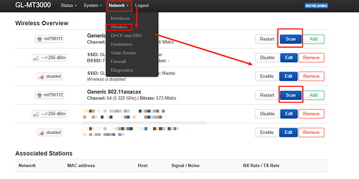

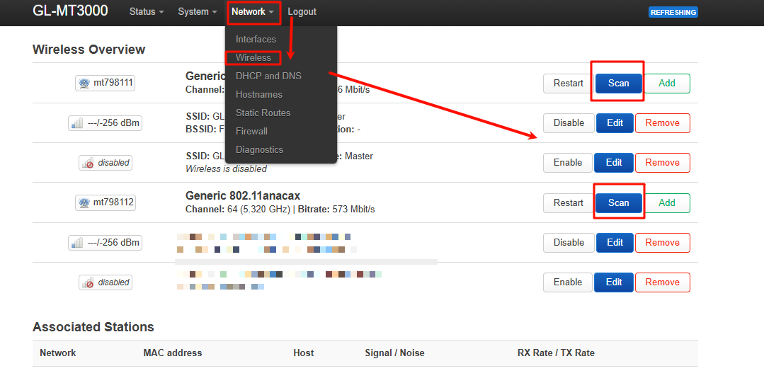

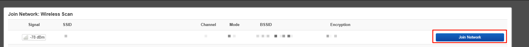

b. In Luci , go to Network > Wireless , click Scan next to the Wi-Fi band (2.4GHz or 5GHz), select your SSID, and click Join Network .

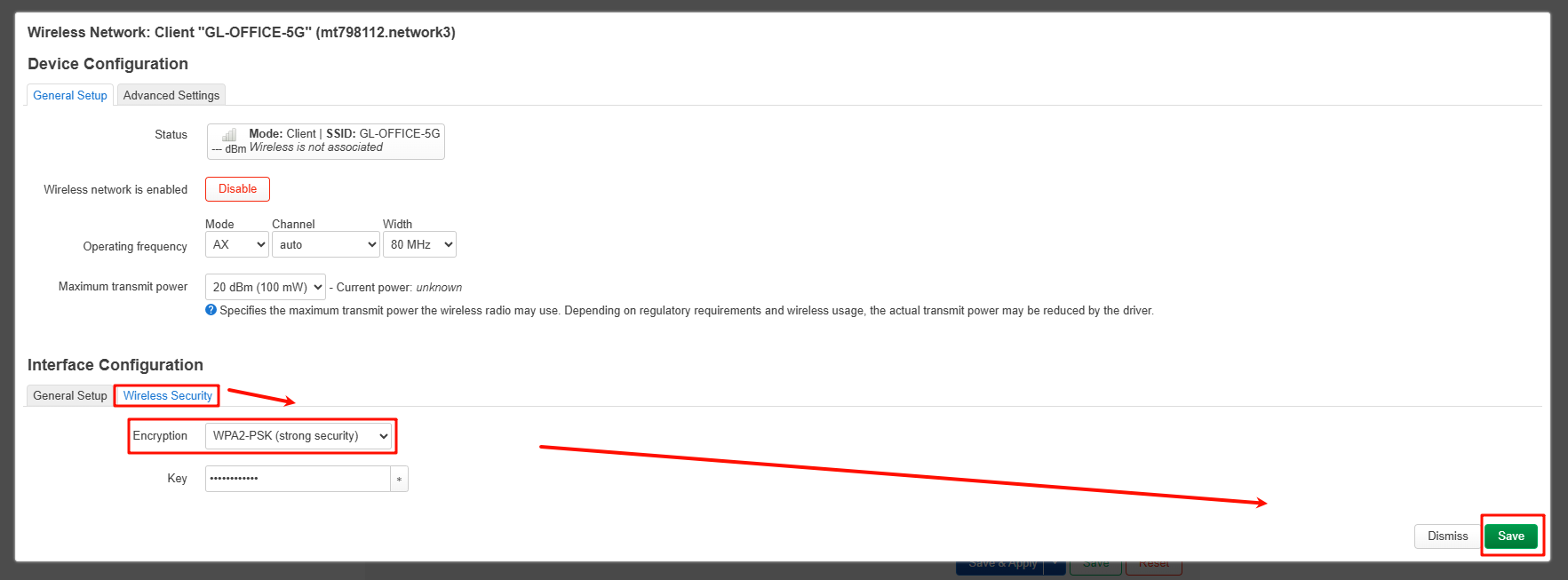

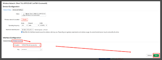

c. Enter the password, then under Wireless Security , change Encryption to WPA2-PSK , Click the Save.
d. Click the Save & Apply. And wait a while for Wi-Fi to connect, and see whether it can connect or not.

I tried the suggested steps after a clean installation of the last stable firmware, 4.8.1.
I had no luck.
Attached the logs and a screenshot
