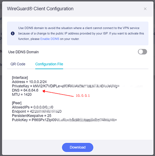

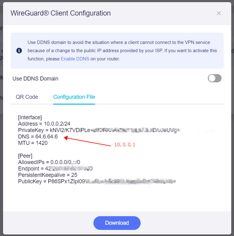

Can you check your wireguard config and change the dns?
Just tried that and it didnt work, it gave errors and couldnt browse anything
Can you give the screenshots of the test.
