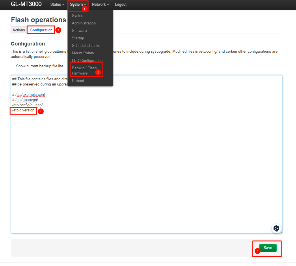

In the future, you may consider adding the /etc/glversion file under Luci - Backup / Flash Firmware - Configuration to include firmware version information in the backup file.
