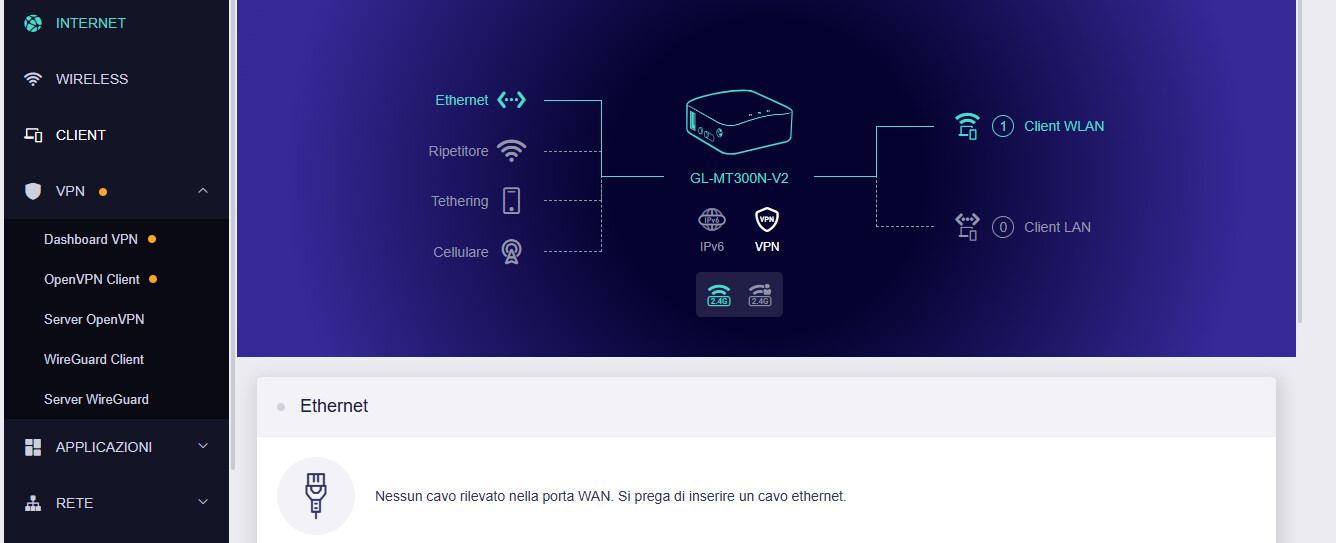

attached screenshot of the dashboard status
if I connect from the phone to the little router it gives me the same error NOT CONNECTED TO THE INTERNET thanks
if the little router is connected to the WAN of the main router, then from the PC I carried out the entire activation procedure through the little router’s dashboard, I changed the passwords and the procedure to activate my VPN, then it disconnected and reconnecting it with the new passwords it does not give me access to the internet, which should be from the Mango to the main router where the connection is active. thanks

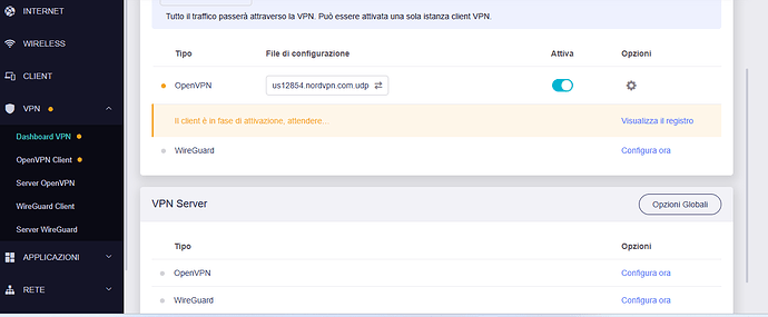

If I disable the VPN from the dashboard, it connects to the internet regularly, and if I re-enable it, the result is this as shown in the screenshot, and I can't manage to solve it, thanks
It looks like the Mango itself is not connected to the Internet.
Please refer to the following guides and connect it to the Internet before configuring or enabling the VPN:
I redid the procedure by now from memory, but nothing. If I disable the VPN (Internet Wi‑Fi works regularly with the MANGO), if I reactivate the VPN switch it gives me no internet connection and, of course, no VPN connection either. I can't find the error, or better yet, what am I doing wrong? Thanks
If you have internet without the vpn, but not with the vpn, it suggests to me that this is in the Mango configuration and nothing about the physical parts. It makes sense that if the vpn has a kill switch, then no tunnel, no internet.
Do you have another device that can connect to the VPN server with the same credentials? Is the VPN server private or a commercial server? I have often found I needed to geerate credentials specific to the Mango to connect to my commercial VPN provider.

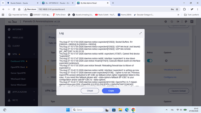

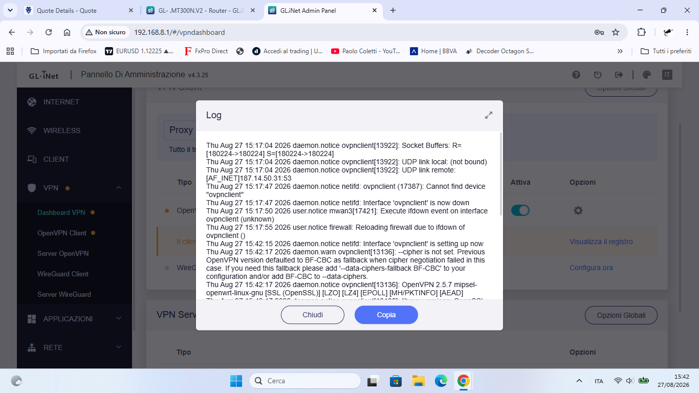

I have NordVPN and can use it on 3 different devices. At this point, I think it depends on NordVPN’s configuration files. When I turn off the VPN toggle, everything works; if I turn it back on, there is no internet. So the UDP files must not be working, but the strange thing is that everything works fine on other devices. Thanks.
Has to be an authentication issue. What do the logs say?
From this latest log, I wouldn’t know how to interpret it, but thanks anyway.
the screenshot cuts off at the good stuff. Post what follows.
Thank you for the information.
To rule out interference from using multiple VPN connections, could you temporarily disable the VPN on your PC and Firestick?
Then enable the OpenVPN client on the Mango and check whether it can connect normally.
If it still cannot connect, could you please download a new .ovpn configuration for another recommended NordVPN server and test it on the Mango. During this test, please keep the VPN disabled on the other devices so that only the Mango VPN is active.
If neither configuration can connect, could you please reproduce the issue once and send us the complete OpenVPN log by private message.
