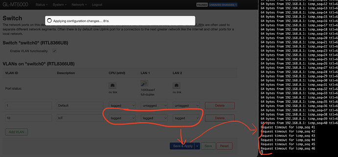

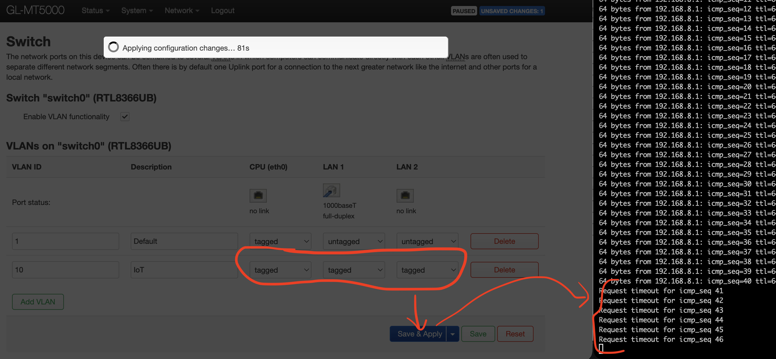

OK, I hit a wall trying to use GL.iNet firmware. Even using LuCI, I was not able to have a trunk setup with tagged and untagged VLANs on the same port.
I will now try to build a 25.12 version from the official branch using the GL.iNet pull request. I know it will have support to a single Ethernet port, and I will check if VLAN support will work as expected.
I feel like you have done something wrong here as this is certainly possible? What exactly doesn’t work when you try and configure this? Can you share screenshots of your config pages etc?
Well some documentation about it would be really nice.
I learned a few things with this with the Brume 3 and their MTK SDK.
For this router in specific you could better follow the QSDK specification this means everything about DSA should be more motivated to swconfig nuance.
So this means... You absolutely need to configure a 802.1Q device manually, like which is more common to swconfig.
Then under network -> switch you then need to specify the vlans, one problem though lan1 (eth0.1) is the cpu I believe or it was lan2 (eth1), the issue I found myself in that you cannot properly segment the vlans invidually per port, one port will work the other will fail or it will work but on both ports, I never got a proper solution for this though, I found it very complicated, the problem start when you try to segment on this cpu lan port.
As for tagged traffic from upstream... Maybe just only defining a 802.1q device is enough.
What I was trying to do is really very simple, basic VLAN trunk. Starting clean after a firmware config reset, I enabled LuCI and I created VLAN 10, assigning it as “tagged” egress in both LAN1 and LAN2 (while keeping the default VLAN 1 as untagged). This is the configuration I am using in my network, since each AP will assign VLAN 10 to the guest/IoT wifi SSIDs.
As soon as I apply this config (see below), I immediately lose connection to the router. Maybe I am observing the bug reported here? BTW, I am running 4.9.0 beta1.
Seems like it, perhaps bug report has been missed being on Reddit so hopefully you raising here will bring some attention. Have you tried this? Unable to create VLAN on GL-MT5000 Brume3
Try on the other port :+1:, this is kinda what I also was seeing.
