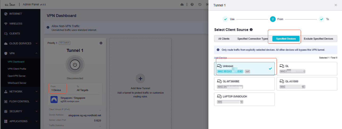

Thank you for the detailed explanation.
The native GL.iNet VPN Policy identifies specified devices by MAC address, so changing the IP address alone will normally not change the VPN route.
However, this can be achieved while keeping the native WireGuard client and GL.iNet Web UI active by adding one source-based IPv4 routing rule.
First, add the computer to the WireGuard tunnel under VPN Dashboard → Policy Mode → Specified Devices → All Targets.
This makes traffic from the computer use WireGuard by default, regardless of which of the two IP addresses it is currently using.
Then, add an exception for the IP address that should use the normal WAN connection.
For example, if 192.168.1.20 should use WireGuard and 192.168.1.21 should use WAN, please run the following commands through SSH:

Thank you for the detailed explanation! Just to confirm: after following these steps, will I be able to use NetSetMan to switch between IPs—using 192.168.1.3 for the VPN and 192.168.1.9 for the normal WAN—so that whichever profile I select dictates the routing path?
Hopefully, in future updates, native IP-based policy routing will be supported alongside MAC addresses.
Yes, after applying this configuration, you can use NetSetMan to switch between different IP profiles on the same device.
For example, with the following setup:
192.168.1.3 → follows the existing WireGuard policy
192.168.1.9 → bypasses WireGuard and uses the normal WAN connection
The routing decision is based on the source IP address, while the device identification in the GL.iNet VPN Policy is still based on the MAC address.
Please make sure both NetSetMan profiles use the same physical MAC address. Do not enable MAC address randomization or MAC spoofing, otherwise the device may be recognized as a different client by the VPN Policy.
