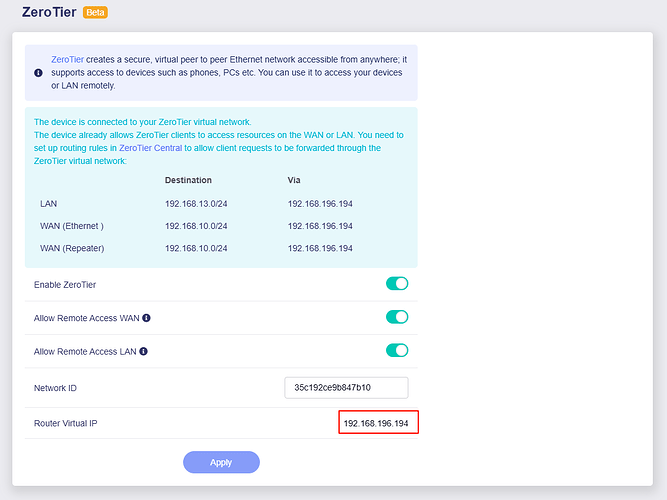

You need to add the routes in Zerotier center:
D: 192.168.2.0/24, VIA: The router Zerotier IP, like 192.168.196.194
Thank you so much, it works!
I'm certain I had tried adding that route previously, but maybe I messed something up. Either way, thank you for the quick response.
