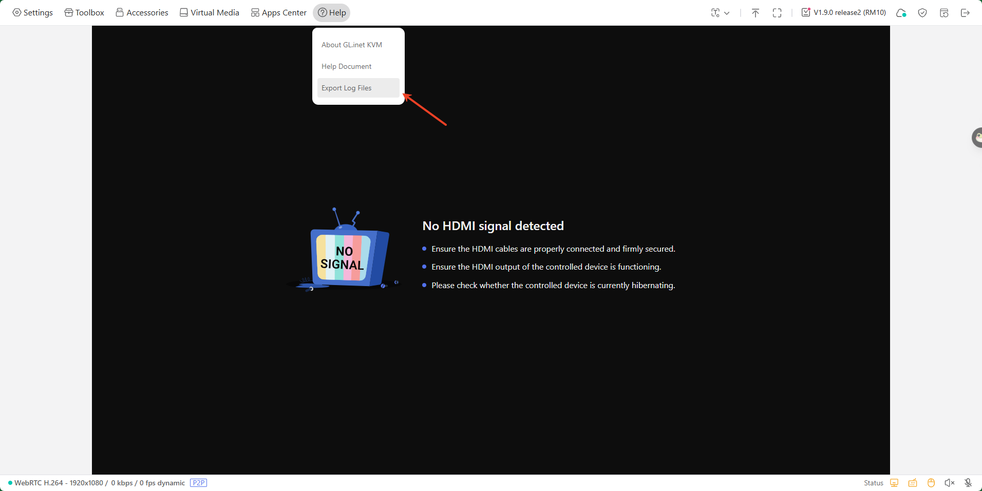

Hi, I cannot see the log file you attached. Can you see that it was uploaded successfully? You can export the logs from the attached image. Also, please ensure that the ATX is connected to the GL-RM1 when exporting the logs.
