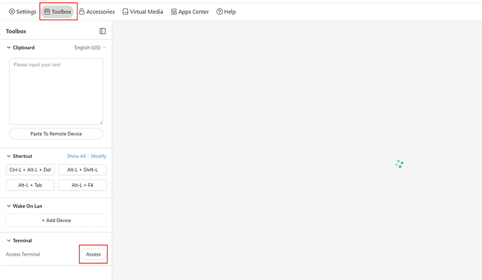

Within the web interface, click Toolbox, then Access to open the device-management SSH terminal page.

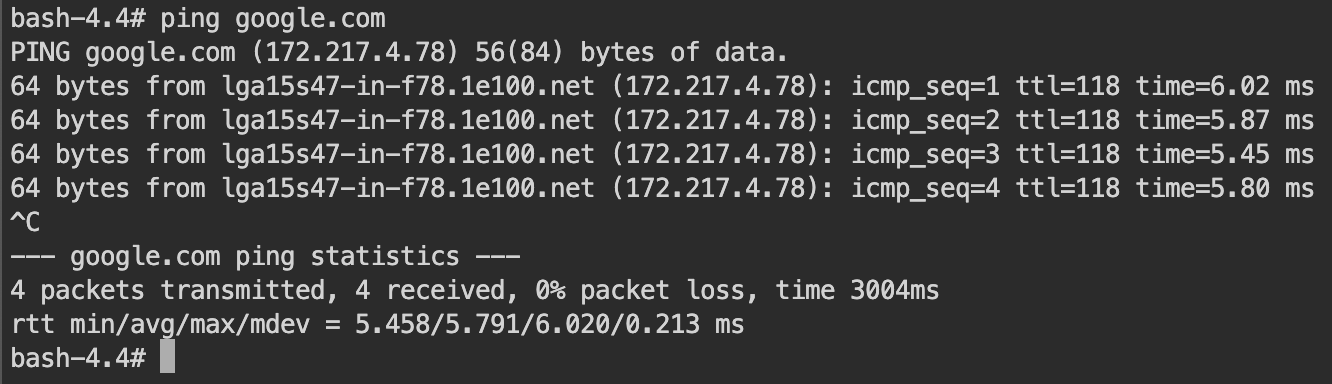

On the terminal page, run the ping command to check whether the device can resolve domain names properly. Please take a screenshot of the results for our review.
ping gslb-us.goodcloud.xyz

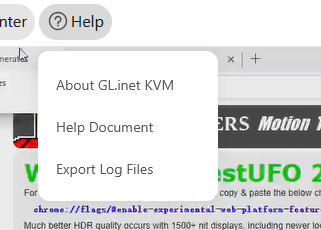

Export the device’s log files by clicking Help, then selecting Export Log Files in the web interface. Please attach these logs so we can analyze them.

Hello, ping is working properly, please see attached.
I also ran the netstat command, and I have that saved. I'm not sure what I should be looking for in that though.
