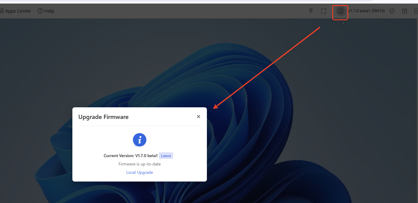

Yes, please keep your firmware up to date.
The latest one is 1.7.2 release.
Where to download 1.7.2?
You can refer to the image below to check.
