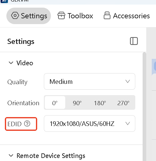

There's a scaling issue with the mouse, the farther you move the mouse the bigger the discrepancy is. There is a similar issue with JetKVM.
This may be caused by a resolution mismatch. You can try setting a different resolution to correct it.
Thanks @robotluo but that doesn't make any difference the problem still persists
