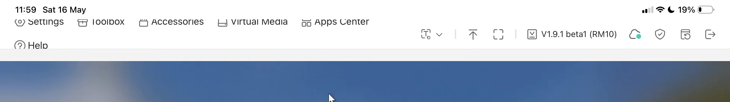

No significant issues yet, except the menu bar doesn’t scale correctly on my iPad Pro.
The menu bar is split across two lines, with part missing on both, it should be on a single line.
This is fine on my MacBook. No such issue with v1.8.2

Just to let you know that firmware v1.9.1 Beta 1 for the RM10 has the same issue.

Just updated RM10 to Current Version: V1.9.1 release1 and the display issues exists in this as well.
As the 1.9.1 r1 firmware build is already finalized (before), this issue probably fixed and merge in 1.10.x firmware.

Just noticed that a new update for the RM1 has been released, unfortunately this hasn’t resolved the issue.

The R&D guy is planning to address this in v1.10, they likely won't be allocating resources for a fix in the v1.9.x minor release.

@bruce Many thanks, I can confirm that the latest 1.10 beta has resolved the issue for both the RM1 and RM1o KVMs and appears to be running with no apparent issues.
