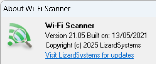

And Wifi scanner
All 3 free tools for personal use.
