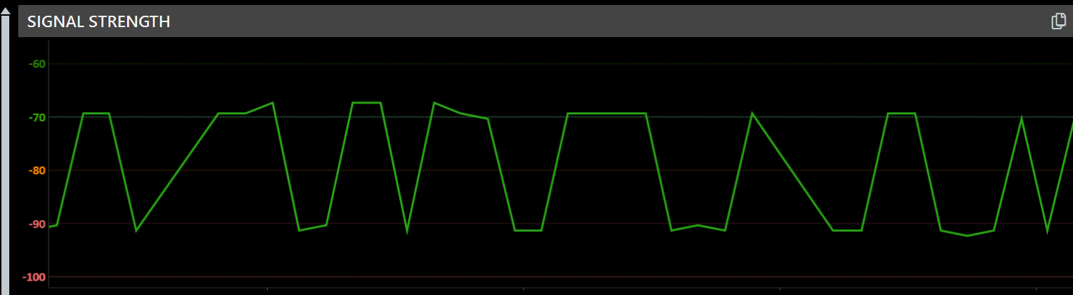

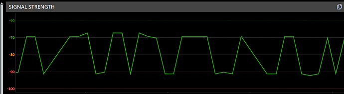

5GHz received power, 2 meters distance … what is causing this low level?
(5G reading, this is client wifi only, 40MHz bandwidth. The 2.4GHz is the uplink)
1 minute timeline

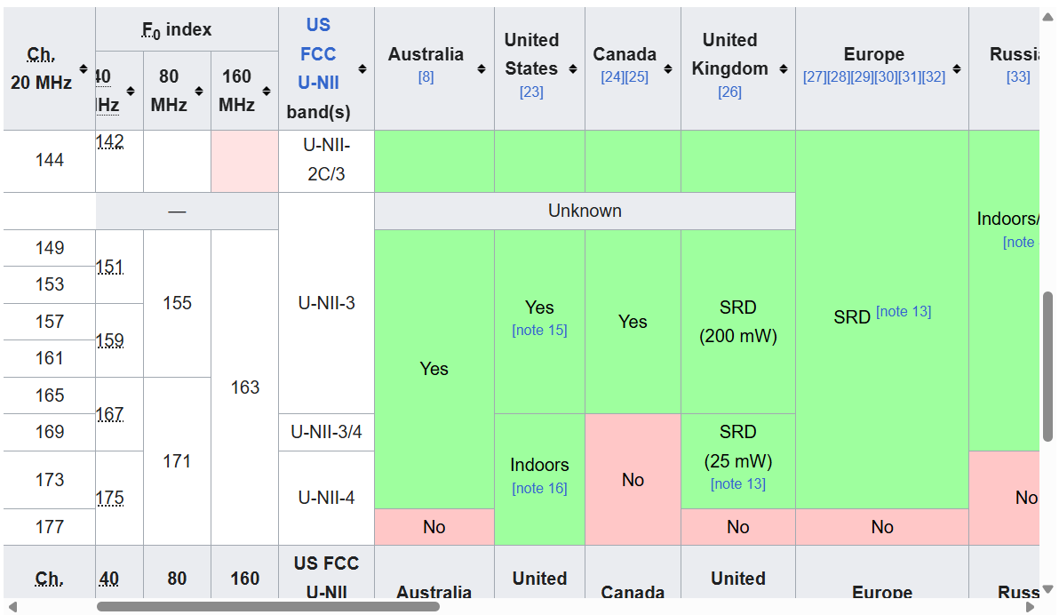

Uplink connection goes back to US or JP, specifying higher 5GHz channels as possible. (149-165) . Those are not valid for Europe. When setting the correct country code in the Wireless LAN interfaces, it is adjusted. Until you loose the uplink connection, then it goes back to the US/JP default channel list. And in Europe none will be found.
When the wireless radio is set to the correct country (in LUCI), then it adjusts to usable channels. At least for a while.
They are valid for the UK though:
ETSI regulation (indeed UK has a different set of allowed frequencies)
And rules change. Newer (AX) hardware/firmwares (not every device (AC) can implement them) allows for the SRD (short range devices) on those frequencies. SRD has dramatic low power/performance (25mW/14dBm for the ETSI region !) Too low for normal wifi usage. Even UK has EIRP reduced from 1000mW/30dBm for channels 96-144, to 200mW/23dBm for channels 149-165, but that is at least usable TXpower.
see at List of WLAN channels - Wikipedia

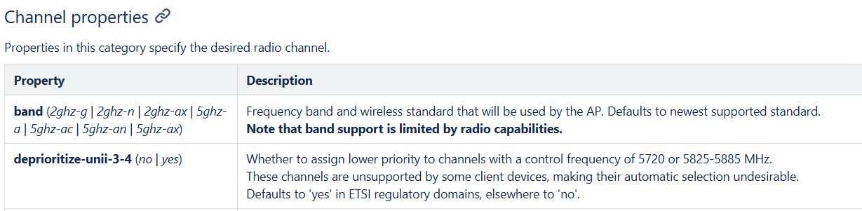

Latest Mikrotik (7.20.6) implementation now has an option for this.
