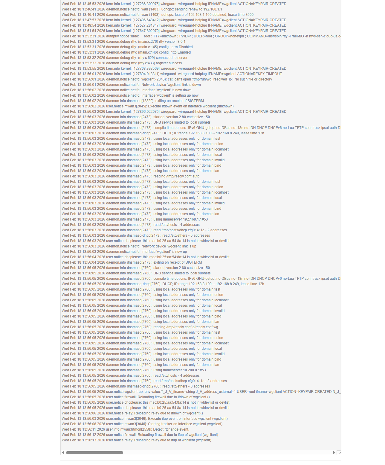

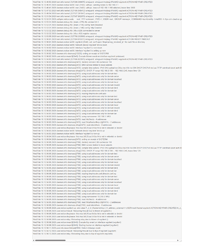

The user experiences brief internet drops (from a few seconds up to ~2 minutes) during long sessions (gaming/poker + YouTube).
In the system log I consistently see:
  • ACTION=REKEY-TIMEOUT
  • Network device 'wgclient' link is down
  • Interface 'wgclient' is now down
  • udhcpc: sending renew to 192.168.1.1
  • lease obtained
This suggests that the WAN interface briefly loses connectivity, after which DHCP renews and WireGuard reconnects.

According to the logs, the issue is not related to DHCP renewals, but rather to the connection between the SFT1200 and the upstream router or ISP network.
Mon Mar  2 19:29:32 2026 user.info mwan3track[31213]: Lost 5 ping(s) on interface wan (eth0.2)
Mon Mar  2 19:29:48 2026 daemon.notice netifd: sf_eth_event port 1 updown 0 is_wan 0 vlanid 1 ifname eth0
Mon Mar  2 19:30:25 2026 kern.info kernel: [16309.634830] wireguard: wireguard-hotplug IFNAME=wgclient ACTION=KEYPAIR-CREATED
Mon Mar  2 19:30:40 2026 user.info mwan3track[31213]: Lost 4 ping(s) on interface wan (eth0.2)
Mon Mar  2 19:31:41 2026 kern.info kernel: [16385.002623] wireguard: wireguard-hotplug IFNAME=wgclient ACTION=REKEY-TIMEOUT
After mwan3 detects a WAN ping failure, a WireGuard rekey occurs afterward. This suggests the problem is more likely tied to the link between the SFT1200 and the upstream.
