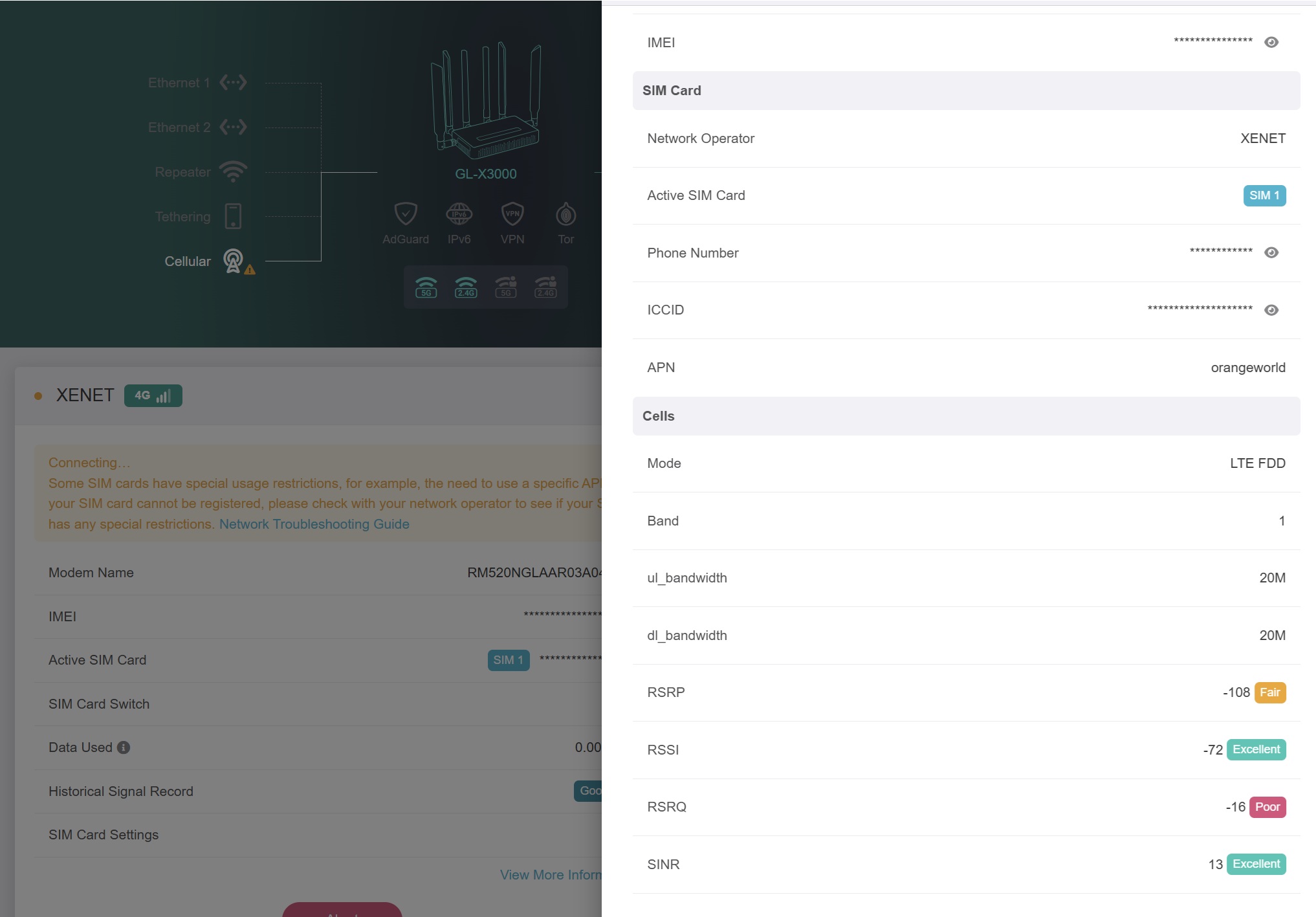

I can see that the SIM gets registered, gets coverage and reach the closes tower but it is not getting internet connection. I am not sure about the root cause of the issue but it seems the GL-X3000 is not processing well the information received from Xenet. It stays all the time in "connecting" status.

I am adding more information and some screenshots about the problem

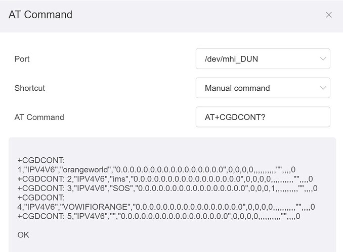

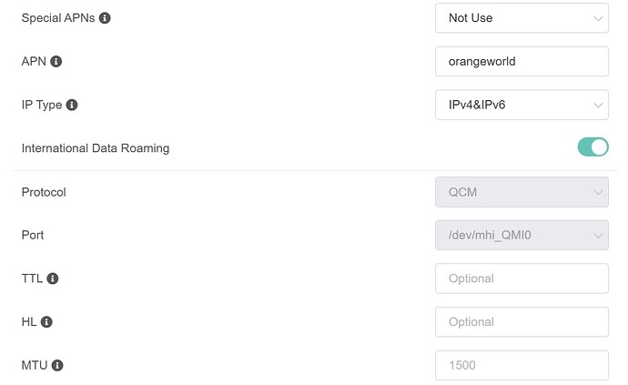

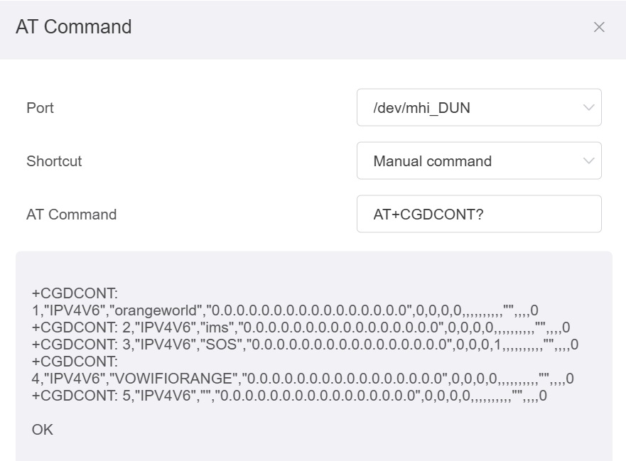

On the profile I tried ipv4, ipv6, both and band selection, none of the configurations makes the sim work

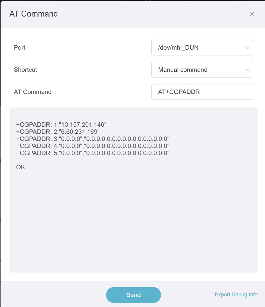

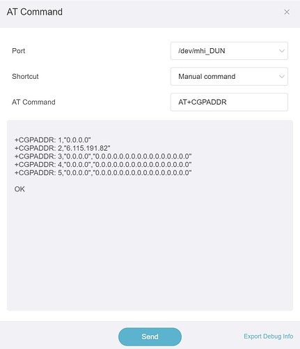

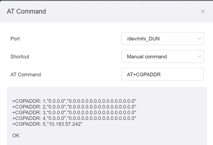

the AT CGPADDR returns an IP always in the register 5, the other 4 registers are always 0.0.0.0

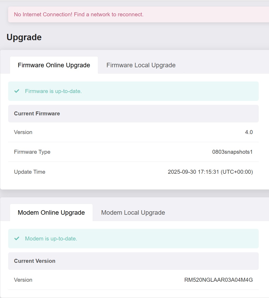

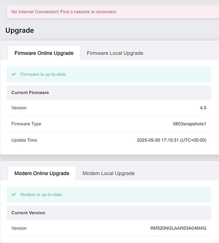

Firmware version used

What Software version you are running I was running a Beta software version with Tmobile I rebooted the device an had the same issue I had to restore back to 4.7.4 which resolved my issue
I will try that version you are mentioned, I tested with the stock, latest stable and latest beta 4.8.3. None of them work
