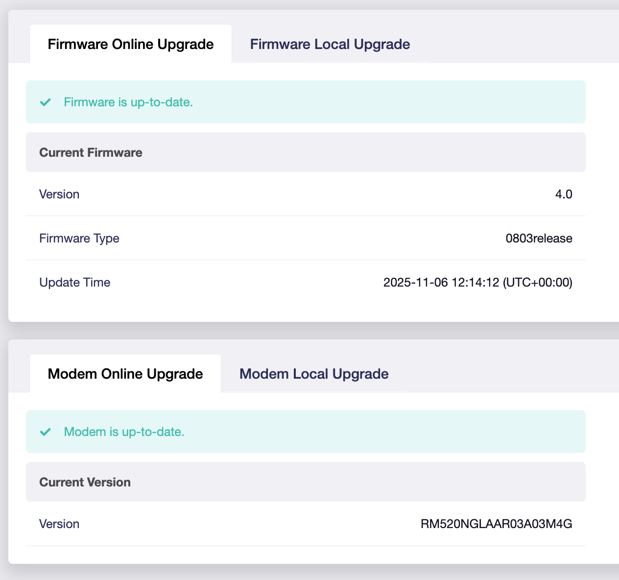

GL-X3000 Cellular network/cell selection (using eSim)
I’m using a SIMPoYo physical esim in slot #2, and have a roaming travel esim programmed onto the simcard. It works well, the connection is active as expected.
However, in this case this is a roaming travel eSim that charges differently depending on the local PLMN that I connect to. By default, the router seems to connect to the most expensive network. So I want to change that to the national operator (Better quality, better price).
I’ve tried Lock Operator, both with Lockmode “manual“ and “manual+auto“. I’ve also tried “lock tower“. In all cases the scan starts normally, takes a minute or two, and then shows no result. Simply the previous page with the “Scan“ button is displayed again.
Does this not work for Sim slot #2? Or perhaps it does not work for eSims? What can be done to get this to show a network list correctly (and then lock)?

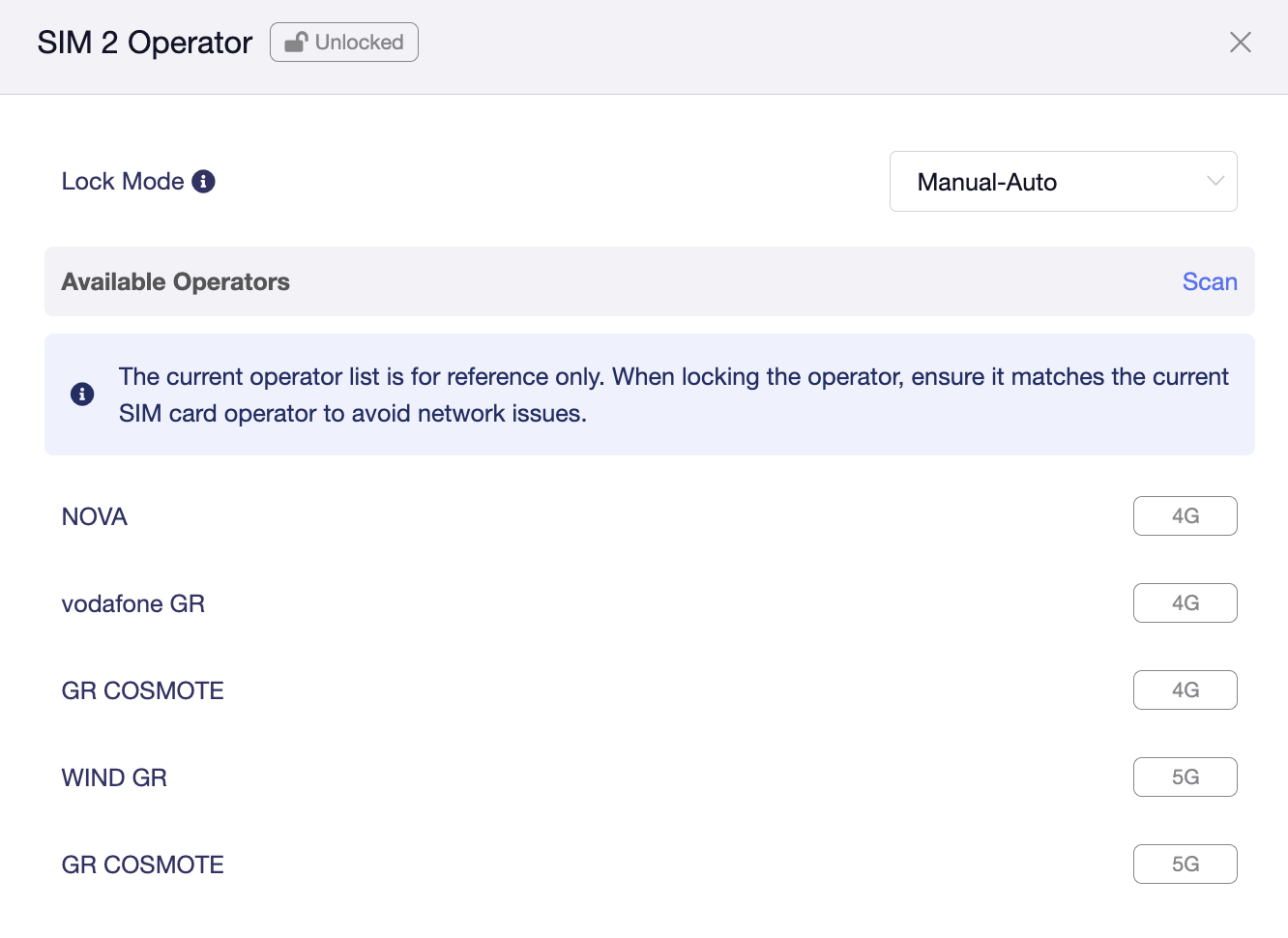

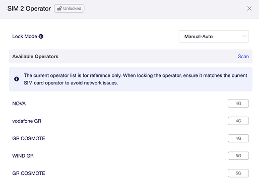

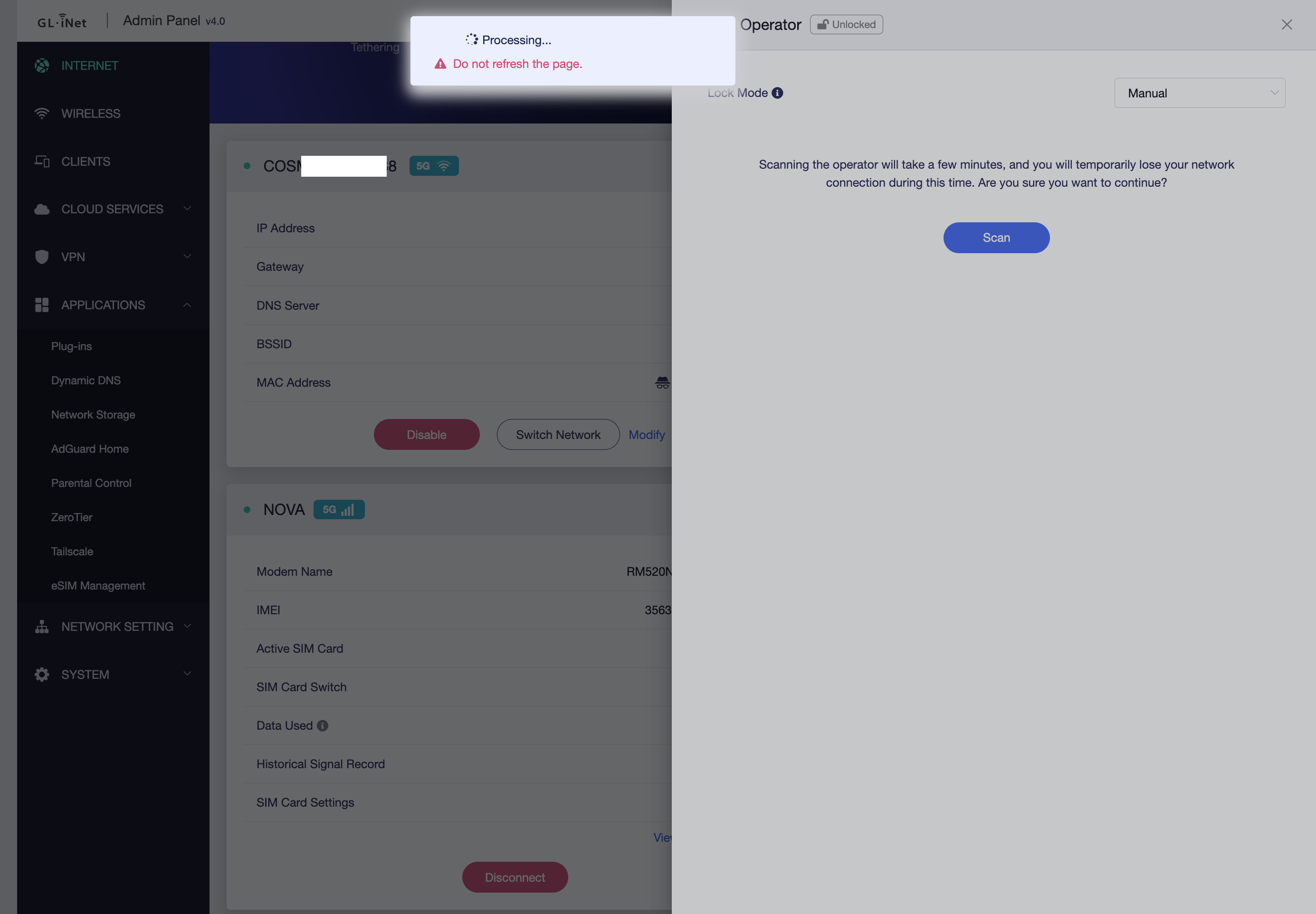

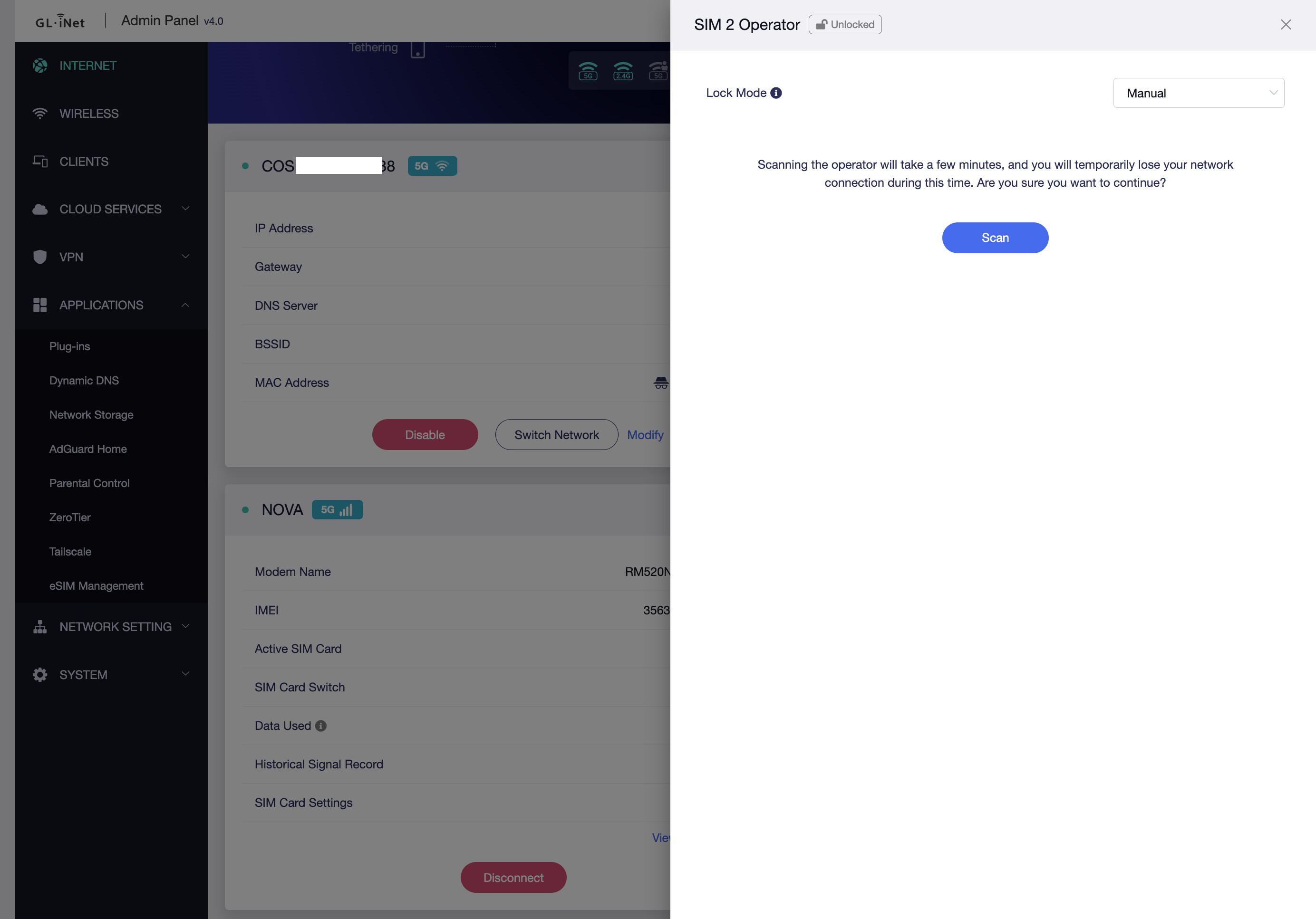

Scanning:
Scanning complete:
The same (type of) esim on a regular phone allows selecting other network(s) without issue. The network and simcard allow/support this.
Thank you.

Thank you for the detailed information and testing.
Since the modem can scan the available operators and switch to the selected PLMN successfully through the CLI, it appears that the modem and eSIM are able to perform operator selection normally.
To help us check what happens when the scan is triggered from the Web Admin Panel, could you please SSH into the router and run:
logread -f | grep -Ei 'modem_AT|cellular_manage|COPS|operator|scan'
Then please run Lock Operator → Scan again from the Web Admin Panel, wait until the scan finishes, and share the output generated during the scan with us.
Thank you for your help.

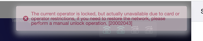

When I execute the “Lock operator“ function it doesnt show any results. The logs show this, seemingly there is a timeout:
Thu Sep 24 16:02:04 2026 daemon.info modem_AT: (at_server.c:205) AT_Read@205 There is not enough time remaining!
Thu Sep 24 16:02:05 2026 daemon.info modem_AT: (at_server.c:960) get_AT_device api Loop count:1
Thu Sep 24 16:02:05 2026 daemon.notice netifd: modem_0001 (27526): [09-24_16:00:05:042] try to requestSetupDataCall 60 second later
Thu Sep 24 16:02:05 2026 daemon.notice netifd: modem_0001 (27526): [09-24_16:00:05:042] your sim card may not support ipv6, please contact your carrier
Thu Sep 24 16:02:05 2026 daemon.notice netifd: modem_0001 (27526): [09-24_16:00:05:042] check whether the sim card has obtained an ipv6 address. AT command 'AT+CGPADDR'
Thu Sep 24 16:02:05 2026 daemon.notice netifd: modem_0001 (27526): [09-24_16:01:05:086] trying to get ipv6 address
Thu Sep 24 16:02:05 2026 daemon.notice netifd: modem_0001 (27526): [09-24_16:01:05:091] requestSetupDataCall QMUXResult = 0x1, QMUXError = 0xe
Thu Sep 24 16:02:05 2026 daemon.notice netifd: modem_0001 (27526): [09-24_16:01:05:091] call_end_reason is 1
Thu Sep 24 16:02:05 2026 daemon.notice netifd: modem_0001 (27526): [09-24_16:01:05:091] call_end_reason_type is 2
Thu Sep 24 16:02:05 2026 daemon.notice netifd: modem_0001 (27526): [09-24_16:01:05:091] call_end_reason_verbose is 210
Thu Sep 24 16:02:05 2026 daemon.notice netifd: modem_0001 (27526): [09-24_16:01:05:091] try to requestSetupDataCall 60 second later
Thu Sep 24 16:02:05 2026 daemon.notice netifd: modem_0001 (27526): [09-24_16:01:05:091] your sim card may not support ipv6, please contact your carrier
Thu Sep 24 16:02:05 2026 daemon.notice netifd: modem_0001 (27526): [09-24_16:01:05:091] check whether the sim card has obtained an ipv6 address. AT command 'AT+CGPADDR'
Thu Sep 24 16:02:05 2026 daemon.notice netifd: modem_0001 (27526): [09-24_16:02:05:141] trying to get ipv6 address
Thu Sep 24 16:02:05 2026 daemon.notice netifd: modem_0001 (27526): [09-24_16:02:05:145] requestSetupDataCall QMUXResult = 0x1, QMUXError = 0xe
Thu Sep 24 16:02:05 2026 daemon.notice netifd: modem_0001 (27526): [09-24_16:02:05:145] call_end_reason is 1
Thu Sep 24 16:02:05 2026 daemon.notice netifd: modem_0001 (27526): [09-24_16:02:05:145] call_end_reason_type is 2
Thu Sep 24 16:02:05 2026 daemon.notice netifd: modem_0001 (27526): [09-24_16:02:05:145] call_end_reason_verbose is 210
Thu Sep 24 16:02:08 2026 daemon.err glc: (api.c:2890) Failed to send AT
Thu Sep 24 16:02:10 2026 daemon.info gl_modem: (modem_network.c:2156) Start lock operator initialization...

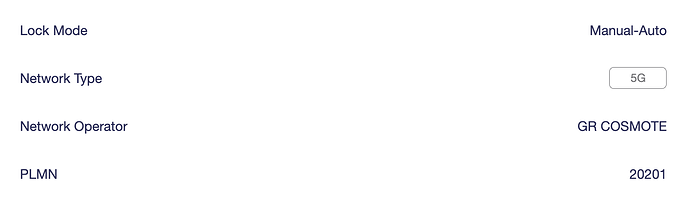

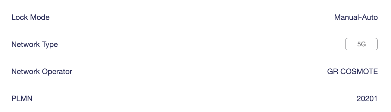

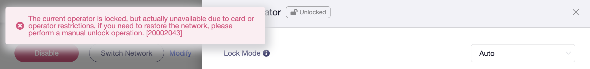

Via the GUI the scan also, sometimes, works. (1 in 4 times perhaps). When locking 202-01 in 5G however, the following message is shown:
The following logs are observed:
Thu Sep 24 17:04:50 2026 daemon.info glc: (api.c:3073) Mode 4 operator registration fails, and the automatic network selection mode has been switched!
Thu Sep 24 17:04:50 2026 daemon.info glc: (modem_cm.c:33) Disconnect from the network
Thu Sep 24 17:04:50 2026 daemon.notice netifd: modem_0001_4 (19238): udhcpc: received SIGTERM
Thu Sep 24 17:04:50 2026 daemon.notice netifd: modem_0001_4 (19238): udhcpc: unicasting a release of 10.204.50.109 to 10.204.50.110
Thu Sep 24 17:04:50 2026 daemon.notice netifd: modem_0001_4 (19238): udhcpc: sending release
Thu Sep 24 17:04:50 2026 daemon.notice netifd: modem_0001_4 (19238): udhcpc: entering released state
Thu Sep 24 17:04:50 2026 daemon.notice netifd: modem_0001_4 (19238): Command failed: Permission denied

And with this failure the lock is not applied (mode 0 / automatic):
gl_modem -B 0001:01:00.0 AT 'AT+COPS?'
+COPS: 0,2,"20201",13
However, manually locking that exact same network still works fine. Note that I am using the same PLMN as given with the GUI (202-01), as well as technology (5G / 13):
root@GL-X3000:~# gl_modem -B 0001:01:00.0 AT 'AT+COPS=4,2,"20201"'
OK
root@GL-X3000:~# gl_modem -B 0001:01:00.0 AT 'AT+COPS?'
+COPS: 1,2,"20201",13
OK
The successful CLI command is not quite equivalent to the GUI selection: AT+COPS=4,2,"20201" omits the access-technology parameter, allowing the modem to choose it. The GUI’s 5G option may be forcing access technology 13.
Please test the exact variant below while the cellular interface is disconnected:
gl_modem -B 0001:01:00.0 AT 'AT+COPS=4,2,"20201",13'
If that fails while the command without ,13 succeeds, the issue is the forced technology selection rather than the PLMN itself. If both succeed, the evidence instead points to the Web Admin Panel workflow or timeout. Please also provide the GL-X3000 firmware version so staff can match this behavior to the relevant firmware branch.

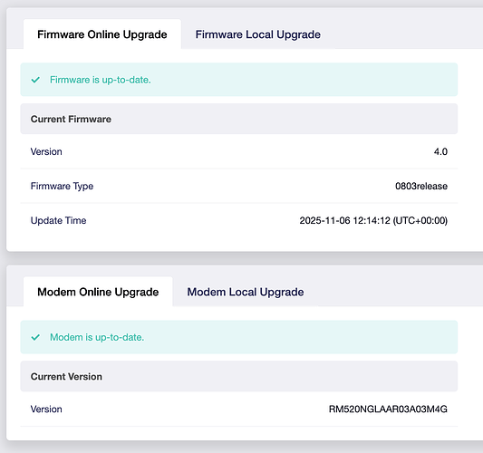

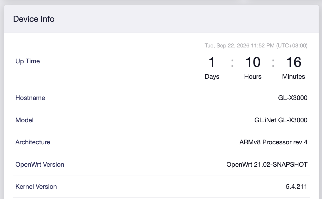

Please provide the GL-X3000 router firmware version shown under SYSTEM → Upgrade. The modem firmware is already visible in the log as RM520NGLAAR03A03M4G; the router firmware version will let staff determine whether this behavior matches a specific firmware branch.
Version info in first post.
Thank you for the additional testing.

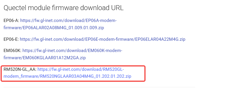

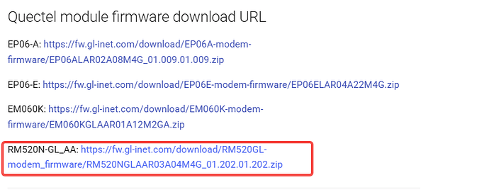

Could you please try upgrading the modem firmware to this version and then test Lock Operator → Scan again?
You can download the modem firmware and follow the upgrade guide here:

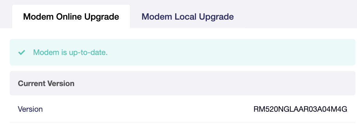

Thank you. Modem was upgraded:
Unfortunately the issues are not resolved.
After the modem update the manually set lock had dissapeared:

Doing a scan via the GUI worked. However, the list is incomplete; Vodafone 5G is missing in this overview. A manual scan is also missing Vodafone 5G. However, this is not correct as Vodafone 5G (NSA) definitely is available (and is used every now and then when automatic selection is enabled).
root@GL-X3000:~# time gl_modem -B 0001:01:00.0 AT 'AT+COPS=?'
+COPS: (2,"NOVA","NOVA","20210",7),(1,"vodafone GR","voda GR","20205",7),(1,"GR COSMOTE","C-OTE","20201",7),(1,"WIND GR","WIND","20210",12),(1,"GR COSMOTE","C-OTE","20201",12),,(0-4),(0-2)
Note that Wind and Nova are the same operator. Meaning that Cosmote is available as 4G and 5G, Nova is available as 4G/5G and Vodafone is only displayed as 4G. At the time of scan the modem was connected to Nova.
Selecting the Wind 5G network causes the following error, and the process is aborted.
Doing the same manually:
root@GL-X3000:~# gl_modem -B 0001:01:00.0 AT 'AT+COPS=4,2,"20210",12'
OK
+COPS: 0,2,"20210",13
OK
+COPS: 1,2,"20210",13
Note that the scan returns mode 12 being available, and the GUI shows this as ‘5G‘. That is incorrect. Mode 12 is 5G-SA, while mode 13 is 5G-NSA. The scan command does not distinguish these two technologies and only returns 5G-SA.
However this does not mean that my sim is allowed to attach to 5G-SA. In this case, I am roaming, 5G-SA is not allowed - and I can only use 5G-NSA. When manually locking to 5G-NSA it works fine.
So, a few issues:
  • The scan command only reports the 5G-SA networks. That means that Vodafone 5G-NSA (Vodafone does not offer 5G-SA!) is not displayed at all in the overview. But it also means that the GUI page does not show 5G networks, it only shows 5G-SA networks.
  • When locking to one of the PLMN/Technologies using the GUI, the lock will be to the technology that was returned by the scan (12 in this case). That technology may not be supported/allowed by the service, resulting in the error above.
  • It does not seem to be possible to scan for 5G-NSA networks specifically.
I would propose three updates to the GUI:
  1. When scanning, display all networks having technology ‘12‘ specifically as “5G-SA“ instead of just 5G like they are now. The scan result shows technology-12, which is 5G-SA specifically. That should be distinguished for clarity.
  2. When scanning, display all 4G networks twice: Once as a 4G network (already the case), and once as a 5G-NSA network. When locking to the 4G network use technology 7 (4G), when locking to the 5G-NSA network use technology 13 ( = 5G-NSA / 4G fallback).
  3. When scanning, also display each unique PLMN without technology. Choosing this would lock to the operator only (omitting the technology setting), meaning simply the highest available technology is used. This is probably what most people are looking for.
Would appreciate your feedback. In my opinion the currently implemented logic is incorrect; you effectively can only scan and select 4G or 5G-SA networks - but not 5G-NSA (Which is what most people would want to use).
Your results isolate two separate behaviors:
  • The GUI is treating access-technology value 12 as generic “5G,” although value 13 represents E-UTRA/NR dual connectivity (5G NSA) on this modem.
  • AT+COPS=? does not necessarily return a separate NSA entry. NSA depends on an LTE anchor, so displaying every LTE result again as “5G NSA” could incorrectly claim that NR is available. A safer GUI option would be Auto / LTE+NR (NSA allowed) for each PLMN, preserving the modem’s RAT preference and omitting the optional <AcT> value from AT+COPS.
There is a closely related GL-X3000 Operator Lock report in which GL.iNet staff confirmed that the implementation needed optimization and provided a patch for testing. Your exact-command comparison adds useful evidence that the current GUI workflow is selecting the wrong mode for this roaming NSA scenario. The modem update clearing the previous operator selection is also expected after rewriting/resetting the modem firmware and is separate from the GUI issue.
This seems to be a similar case. The suggested solution there matches with my proposed update #3. Happy to see that this seems to be coming soon (?).
However I still do believe that the scan results should be displayed more truthfully. meaning networks that are reported back as technology=12, should be displayed as 5G-SA. As that is the exact technology that you would be locking to.
And I would appreciate an option to lock to 5G-NSA (technology=13). Since in some cases, like when roaming - or using a travel esim like this - 5G-SA is simply not allowed by policy. The modem supports this, so why not make the choice available to the user?
Labeling access technology 12 as 5G SA / NG-RAN would be more precise than the current generic 5G label. A separate 5G NSA (LTE–NR dual connectivity) choice could use value 13, but it should be presented as a requested registration mode—not as proof that the scan detected NSA availability, since AT+COPS=? may report only the LTE anchor.
An Auto / operator-only choice that omits <AcT> remains the safest default, while explicit LTE, 5G SA, and 5G NSA options would serve advanced cases such as roaming restrictions. The related topic confirms that staff tested an adjustment and mentioned inclusion in a future firmware update, but it does not provide a confirmed version or release date.
