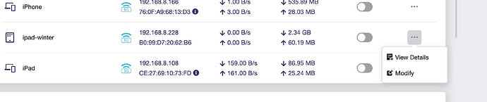

I've recently upgraded to the latest v4 firmware and noticed that the speed limit option is no longer available for clients. Attached is a screenshot. How do I access that feature now?

@yournameismyname Do you have network acceleration enabled? That can affect several features, including client speed limits. It can be found under Network -> Network Acceleration
I will check later, but this was a fresh upgrade after a factor reset. Does the network acceleration feature disable the client speed limit functionality from the UI?
I disabled Network Acceleration and that fixed it. Thanks!
