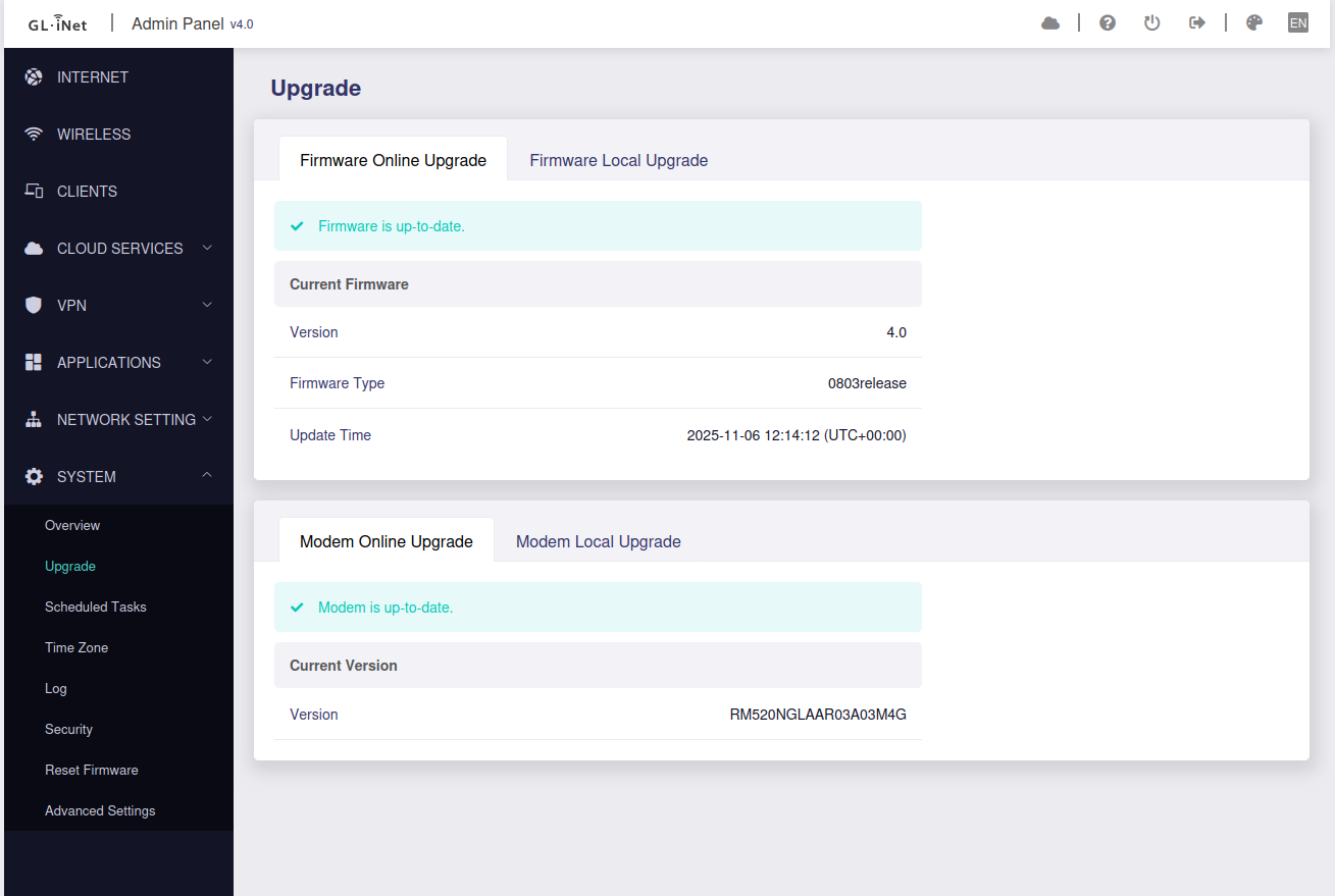

I can confirm that there is no issue for me with RM520NGLAAR03A03M4G using o2 - de SIM-Card.
But I need to confess that I never have had such an issue, even with older versions. Using the XE3000 since about 3 years.
Only issue that appears is that o2 does not properly provision the modem after forced-disconnect all 24 hrs. And modem sticks for 30-90 minutes without internet connection but has “carrier”. Reboot fixes it.
