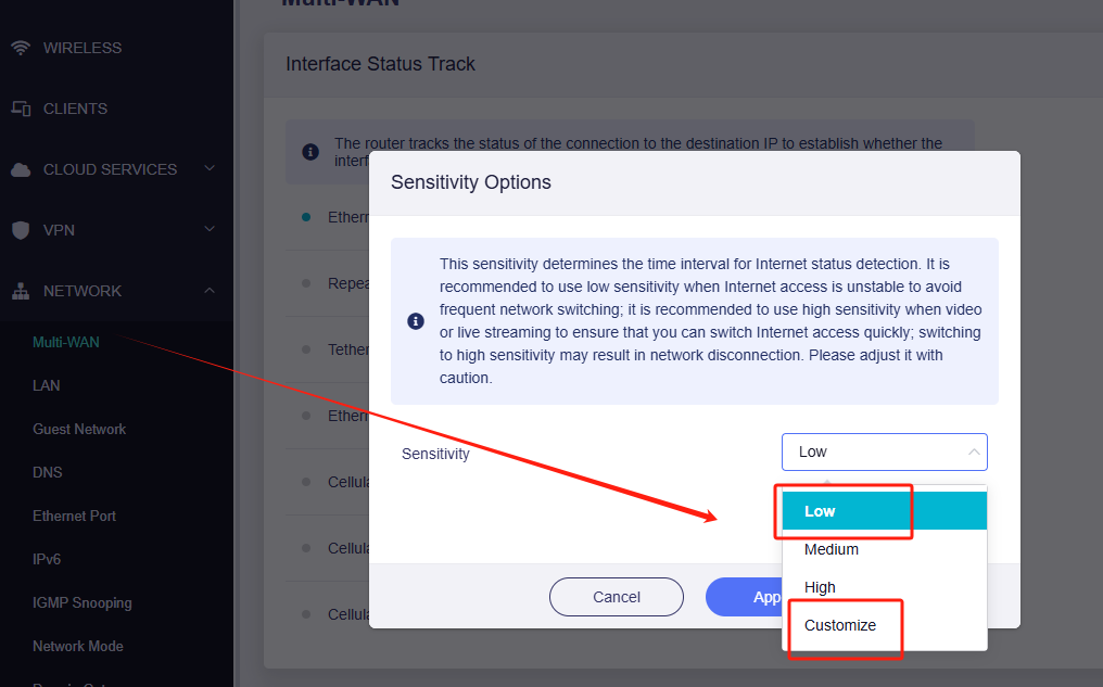

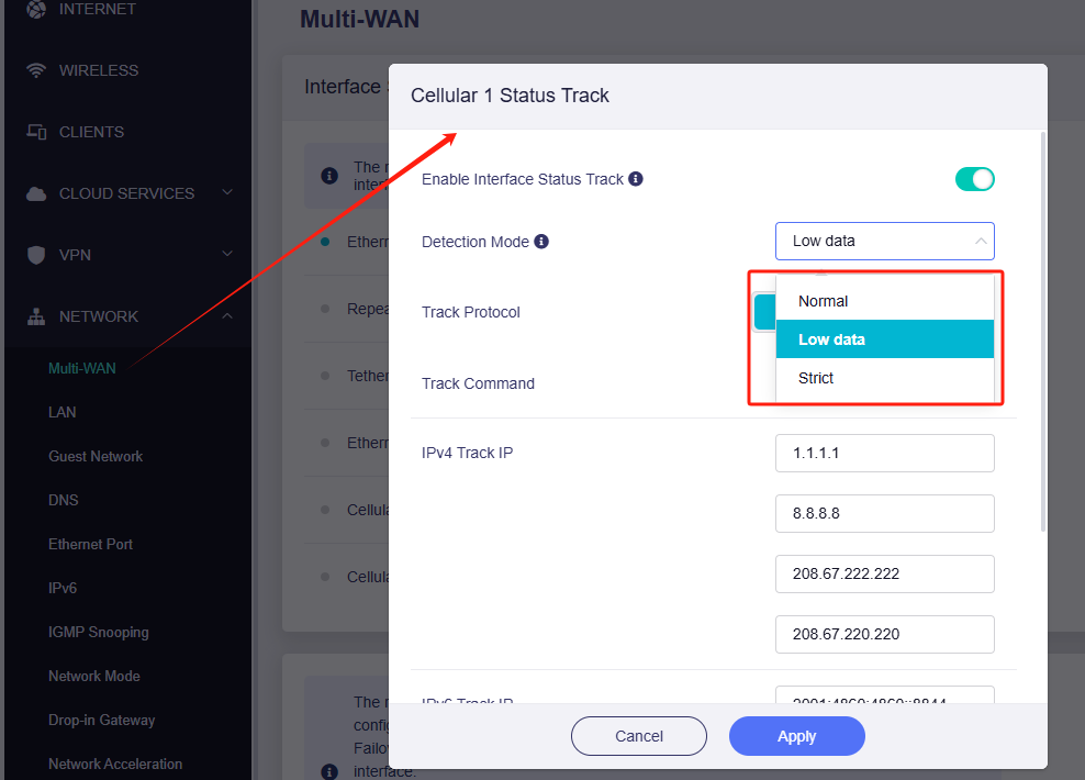

  1. Please check whether NETWORK -> Multi-WAN -> Cellular -> Detection Mode is set to Low data. If it is, please change it to Normal mode and then observe whether the frequent disconnection issue still occurs. Note that Normal mode periodically checks network connectivity, so it will consume a small amount of data.
  2. Please modify /etc/config/cellular/network_check.json on the device and set check_period_sec to 60. This value means the active network connectivity check interval is 60 seconds. In cases of network fluctuation or poor signal/network quality, increasing this interval can help reduce false offline detection and avoid unnecessary dial recovery.

After a firmware upgrade or factory reset, changes made to the JSON configuration file will not be retained. The file will be restored to its default values, so you will need to modify it again manually if needed.
Please also check whether the current network environment is unstable or fluctuating heavily. If the cellular network quality is poor, you may need to lower the kmwan detection sensitivity to avoid frequent dial recovery triggers. You can set the detection mode to Low or Custom in the location shown in the screenshot.
If you have any further questions or need any assistance, please feel free to contact us.
