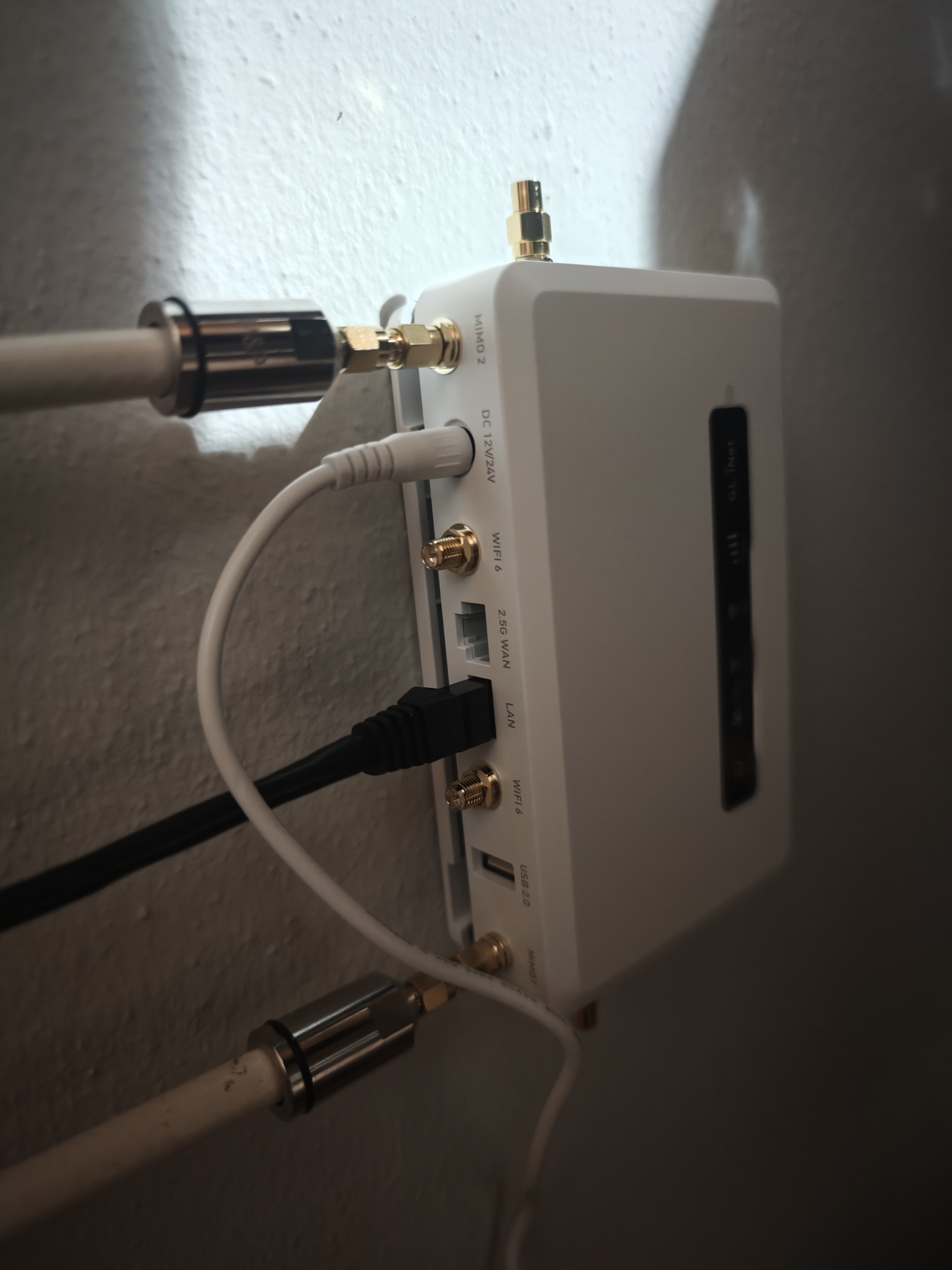

I am reaching out because I am replacing a Teltonika RUTX50 (which suffered from frequent modem radio freezes) with the GL-X3000 (Spitz AX).
My professional setup consists of a Poynting A-XPOL-0002-V3-02 outdoor antenna, perfectly aligned with a BTS that delivers over 700Mbps download speeds. I am using high-end Messi & Paoloni Hyperflex 10 Sahara cables, factory-terminated and weather-sealed.
Since my antenna is a 2x2 MIMO system and the Spitz AX is a 4x4 MIMO router, I have a few questions regarding optimization:
  1. Does the router natively support 2x2 MIMO by terminating the unused SMA ports with 50 Ohm dummy loads?
  2. Are there specific AT commands (e.g., AT+QCFG="antcfg",...) required to force the Quectel modem to operate exclusively on specific ports (like ANT 0 and ANT 3) to ensure maximum stability and prevent radio freezes?
I want to ensure the modem doesn't 'hunt' for signals on the terminated ports, which might cause overheating or SINR degradation.
Looking forward to your technical advice

Hello @luca1975a
  1. It can theoretically support 2x2 MIMO if connected the ANT0 and ANT3.
  2. Sorry, it does not support modifications via AT commands.
The following commands can be used to check the signal transmission and reception status of the current service network:
AT+QRSRP
AT+QRSRQ
AT+QSINR?
