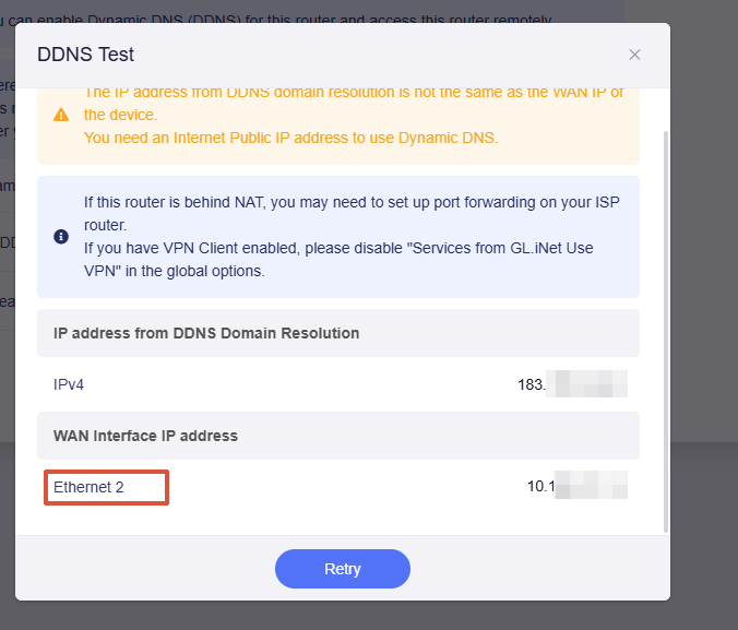

We tested locally using an XE3000 running v4.9.0 Beta 2, and GL DDNS worked correctly even when only the Secondary WAN was enabled:
Could you please check again?
If the issue still persists, please:
  1. Export the device logs and send them to us via private message so we can review the GL DDNS status.
  2. SSH into the router and run the following command to verify whether communication with the configured IP detection server is working properly:
    curl http://checkip.dyndns.com
