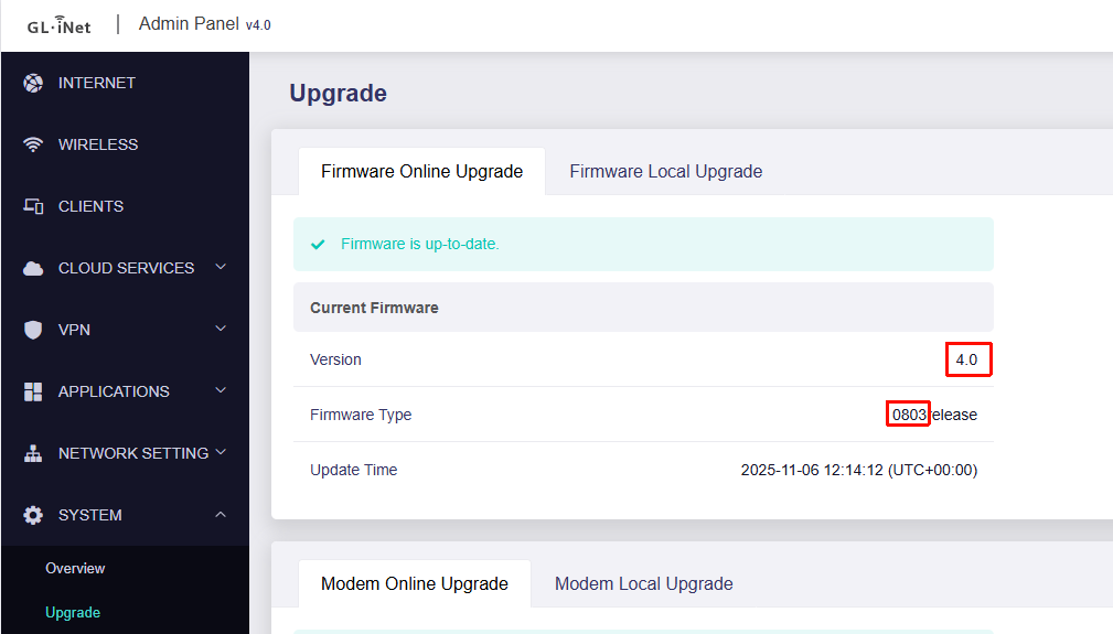

I am worried about the firmware. I seem to be stuck on V4.0 despite upgrading to the lates version.
Is there a way to “force” the upgrade?

Sadly my Router has still not updated to this version, is my router faulty?

The firmware version in the upper top inside the web UI is not about the current installed firmware - at least not always. You will find the current firmware inside the System > Upgrade menu.
Our cellular products display the version information a bit differently.
The Version field only shows the major version number, while the minor version number can be found in Firmware Type.
For example, v4.8.3 is displayed as follows:
