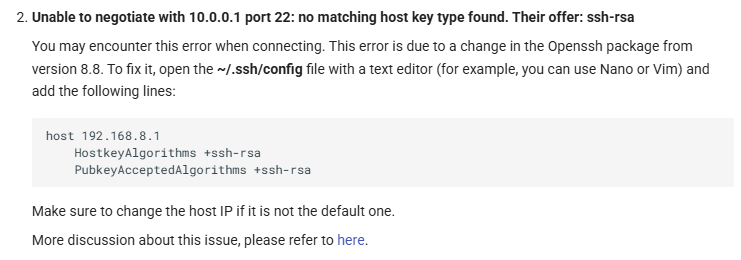

Hi Cathy, thank you so much for getting back to me.
When I try to log in using that ssh command I receive the following message.
“Unable to negotiate with 192.168.8.1 port 22: no matching host key type found. Their offer: ssh-rsa”
I have tried a windows machine and also a Mac and get the same response.
Please try this on windows CMD:
ssh -oHostKeyAlgorithms=+ssh-rsa root@192.168.8.1
For macOS, please refer to the last section of the shared document—“Troubleshooting”:
