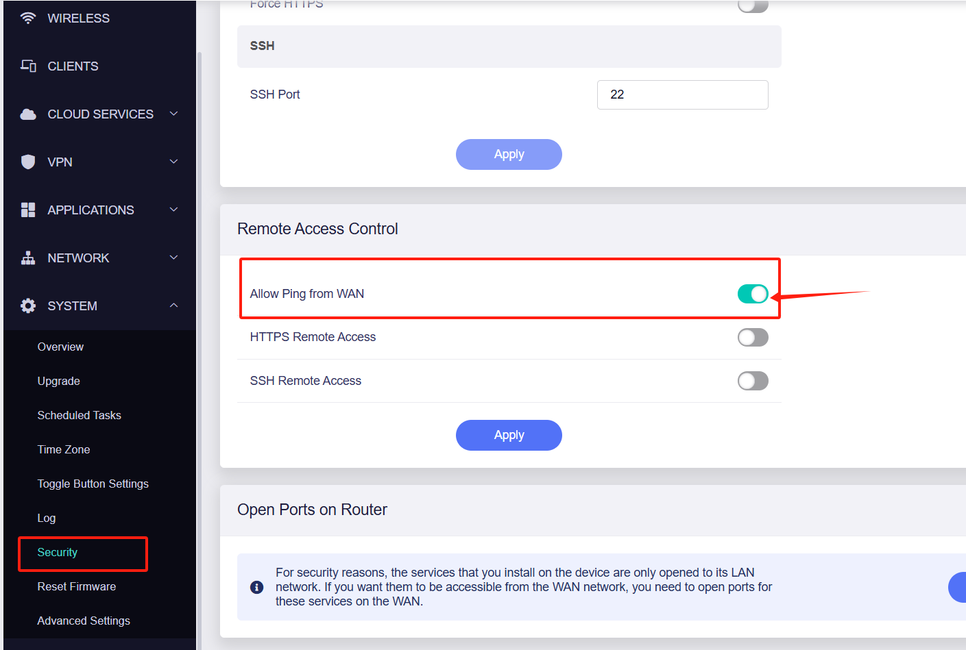

Open the VPN client: Allow Ping from WAN
I don’t seem to have that in my system options. I’m on firmware 4.3.25 and it says up to date.
