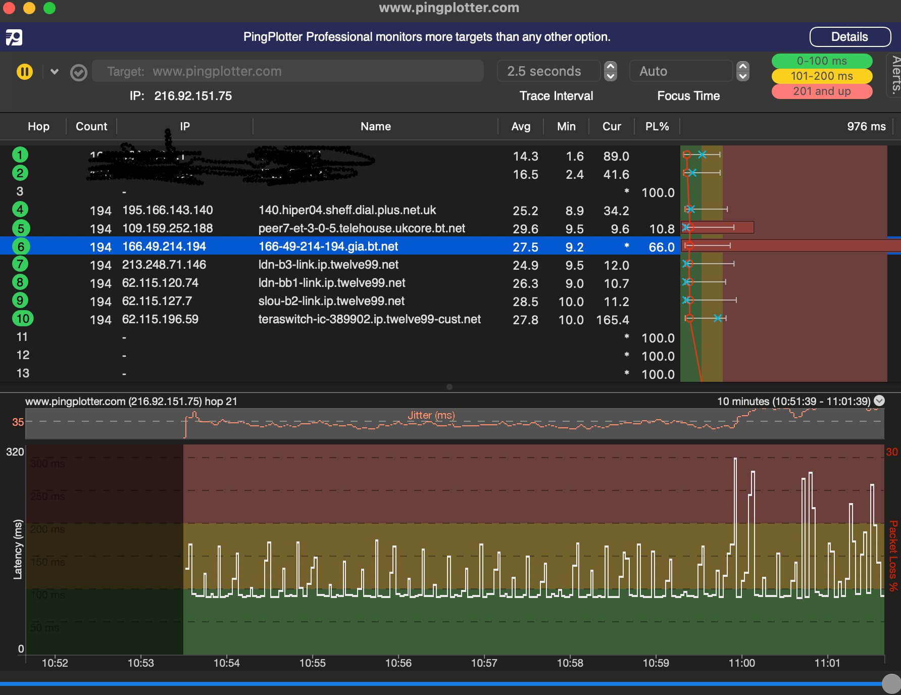

I've tried implementing SQM, (300 down 70 up fibre connection, values in sqm are 0 for download and 55000 upload). My results on the waveform bufferbloat test seem to vary, but currently I dont see any latency on my upload speed, just the download where I'm seeing around +21ms. I've used PingPlotter to have a look at what's going on, and I'm starting to think maybe it's an ISP issue, but feeling a bit lost.

Could you use PingPlotter’s sharing/export feature to send the full measurement results?
Getting Help with PingPlotter Results
From the screenshots shared so far:
  1. It looks like the PC is connected to the router over Wi-Fi, and there is some latency fluctuation on the local link. Since we don’t see clear packet loss in what was shared, it may or may not be related to the in-game issue.
  2. There appears to be a significant latency increase around ~10 hops, but we’ll need the complete trace/results to confirm what happens after that point.
Please also verify:
  1. Are you tracing the actual game server address? The current chart appears to be targeting a pingplotter.com (US) address rather than a UK-based destination. If possible, trace the game server and share those results.

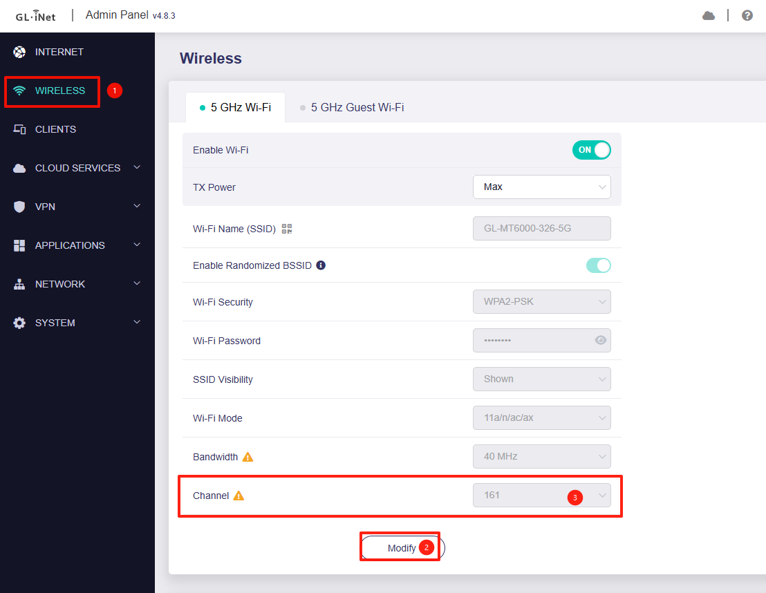

  2. If you’re currently on Wi-Fi, please make sure you are using 5GHz instead of 2.4Ghz.
  3. If possible, please run the same test over a wired Ethernet connection for comparison.
  4. Check for Wi-Fi channel congestion (e.g., macOS Wireless Diagnostics) and, if needed, try setting the router to a less crowded channel/band.
