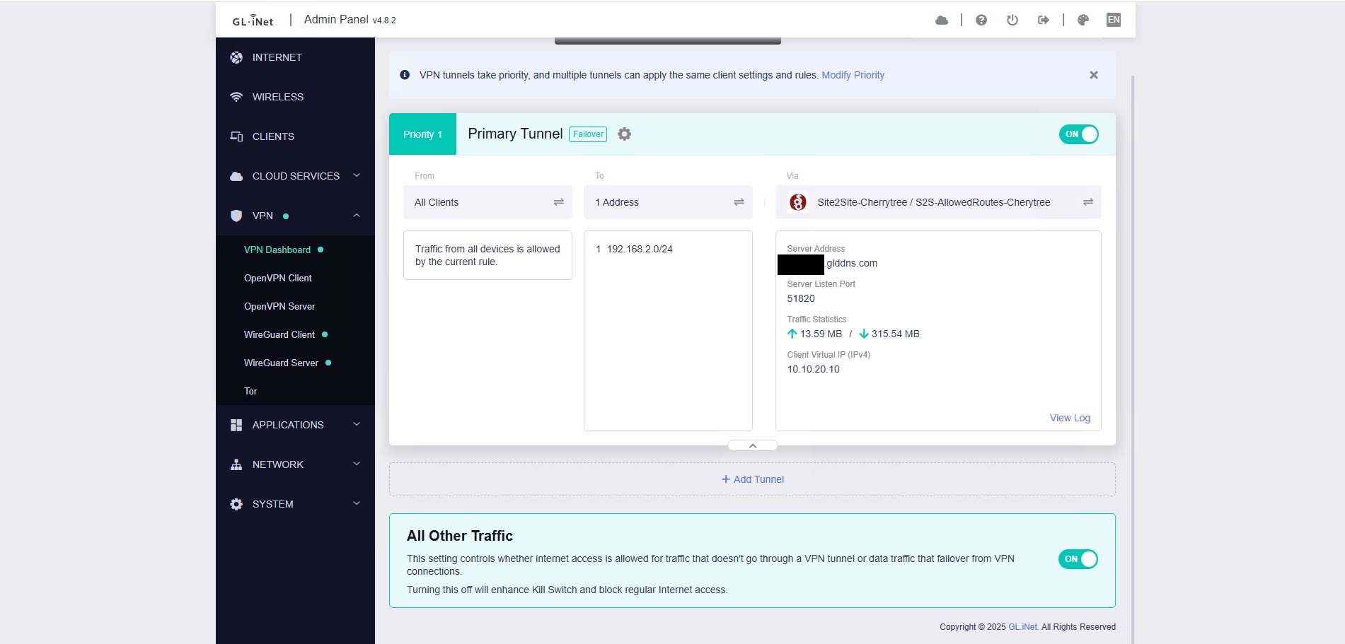

Thank you so much for getting back to me and helping.
Does the attached look correct?
Thank you - I will update to this version and see how it goes.
